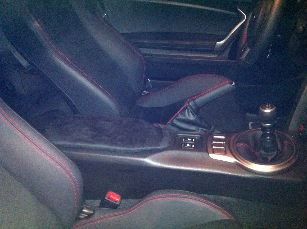

So I got tired of not having an Arm rest in my BRZ so I decided to fab up my own. I'll likely get the OEM once released, but decided I needed something now.
I'm no pro, nor did I do a DIY write up since I'm sure there are those better at these things than am I. Regardless, I thought I'd share. The materials cost me less than 25 dollars and it took about two hours.
Materials:
Hardwood board
Carpet foam pad
Black Suede to match Limited trim
carpet nails
I simply cut out then sanded the hardwood board, then covered the top and sides with the carpet foam using a spray on adhesive. Lastly, I covered the board with the black suede. The trick is to stretch the material over the foam, rounding the edges and securing underneath using the carpet nails.
Pics are bellow - sorry for the crappy iphone photos I took at night. It is very comfy with the carpet bad. It adds a nice feel to the armrest and doesn't leave any indentations.
Attachment 11918
Attachment 11919
Attachment 11920

Love your motivation and creativity but damn that looks mad ghetto ;)

Yep - but I'm a tall guy and was tired of not having a comfy arm rest. This will just hold me over till one is released.

I was thinking something similar... You have it hinged or just on top of?

Thanks guys. The suede matches the seat inserts real well. I was going to make it hinge(bought the parts) but didn't end up going that route. Right now there is a smaller cutout on the underneath side that holds it snug in place. Red stitching would be neat but beyond my skill. I don't think it looks too getto either but different strokes I guess.
