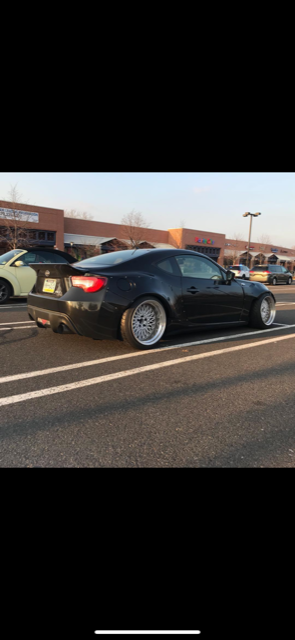

Hey wassup guys, so I知 getting my RB V1 soon and I was hoping you guys could me find the correct specs for wheels/tires for a flush set up with hardly any to no camber(2 Degrees) if possible.
I was also wondering if it痴 possible to run a square set up? But If I cant run a square set up for a flush look then staggered is fine.
I知 trying not to run any Spacers cuz I heard there not safe but I知 honestly not all that sure about that tbh. But yeah guys i壇 Appreciate you guys helping me out, feel free send pics with your guys set up if you want that would help even more! Thanks!

very large and very aggressive, i run very little camber in the rear and around 4 in the front, i have some poke so you can use these specs to go off of where you would like to be
F 17x10.5 -28
R 18x12.5 -10

Nice thank you, this looks like it would be very very aggressive, do you have any pics by chance? I知 curious how this looks tbh
evomike 10-04-2019 01:07 PM
Attachment 181717
evomike 10-04-2019 01:08 PM
posted

I think this looks nice bro definately meaty with a bit of poke
