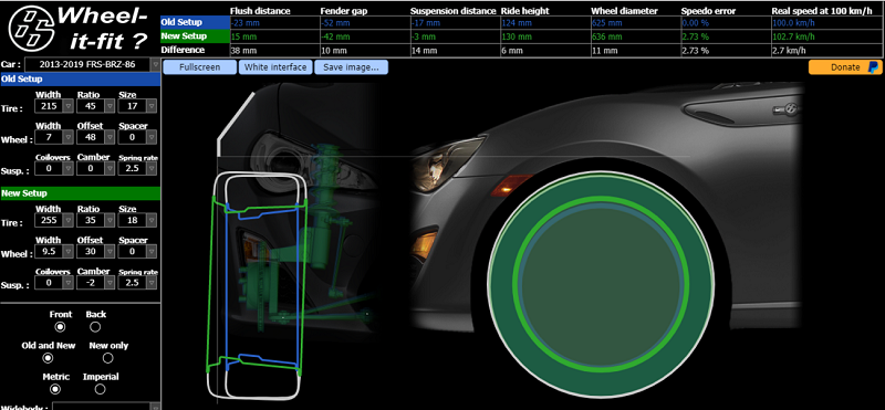

2 Attachment(s)
Originally Posted by mrha (Post 3262088)
So I read on the forums that 18x9.5 +45 fits on our cars without spacers. I put the wheels on tonight and to my dismay found that the tires are right up against the spring perch. I'm using 255/35/18 tires on these rims.
I'm gonna guess that everyone that got them to fit is using coilovers vs stock struts? Is there any detail that I'm missing here? Thanks everyone for any help you can provide.
Stock struts already have a hard enough time fitting 18x9.5 at +38 offset... Idk where you heard 18x9.5 +45 fits comfortable on stock struts but for next time,use the wheel calculator at https://www.ft86motorsports.com/wheelitfit/
This is your setup currently at stock height and nothing else added (given your notes in your post). If you're running camber bolts or anything else, it may affect your fitment but idk so I"m using base numbers as a guideline.
Attachment 181610
Clearly it has 12mm clearance issues.

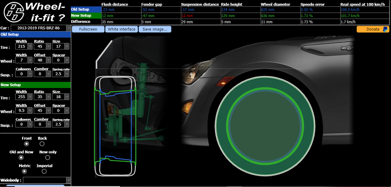

The other thing you can do is get 15mm spacers to clear the perch. The 15mm will make your wheels technically +30 offset in this case. To dial in the poke you'll have at +30 offset, I then recommend camber bolts to about -2 degrees to tuck in the wheel. In theory it should clear with these add-ons.
Attachment 181611
If this all seems too complicated... Just get a set of coilovers and you won't have to worry about a +45 fitment on a 9.5 wheel. Hope this helps!
