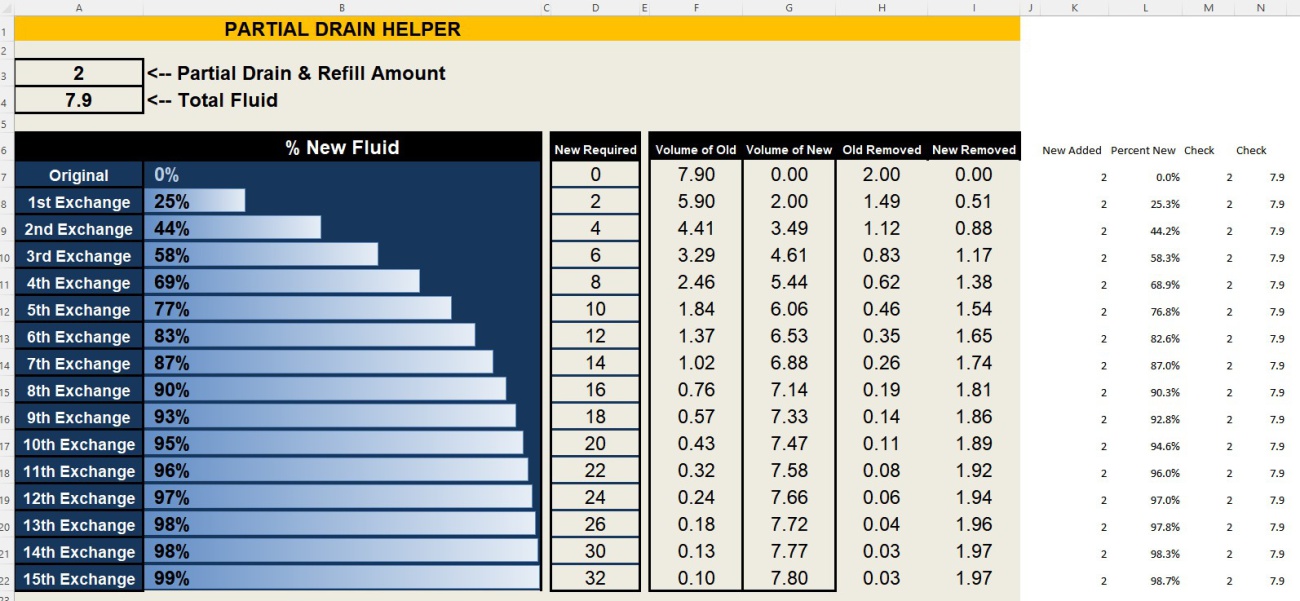

The attached excel Partial Drain calculator was posted on the Bob is the oil guy forum a few years ago. Attachment 224007
If you plug in 7.9 qts in the Total Fluid box and 2 qts in the Partial Drain and Refill Amount box it calculates it would take 16 qts of new fluid to reach 90% new fluid. How accurate is this calculator???

Thanks for the info. I have 12 qts of the Valvoline Multi-Vehicle ATF. I could do 5-6X drop and fills if you can get only ~2 qts out a drop.
Here's a screen shot of the partial drain helper:
Attachment 224016
