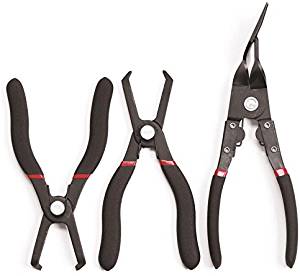

there are some tools you need
1.clip remove tool
2.27mm socket
3.general tool box
mainly 10mm and 12mm socket
jack stand
4.high temp sealant
5.29mm open wrench
6.6.5L engine oil
7.that space for doing to oil change
8.tape for cover the fender and headlight prevent scratch the paint by the time you take off your bumer

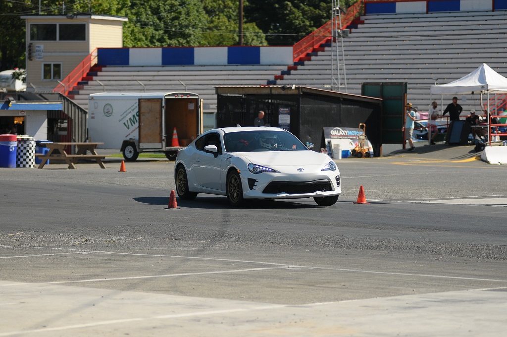

Auto X
[ame]http://www.youtube.com/watch?v=y2Z0IPcxFyA[/ame]
it was my third auto x
need more seat time
not the best of the day cause my go pro is died
this was the second best.
but i manage myself got first in all the gt86!
class in stx just because the 245 tire size compare to the stock
i may going to stock size next time!
