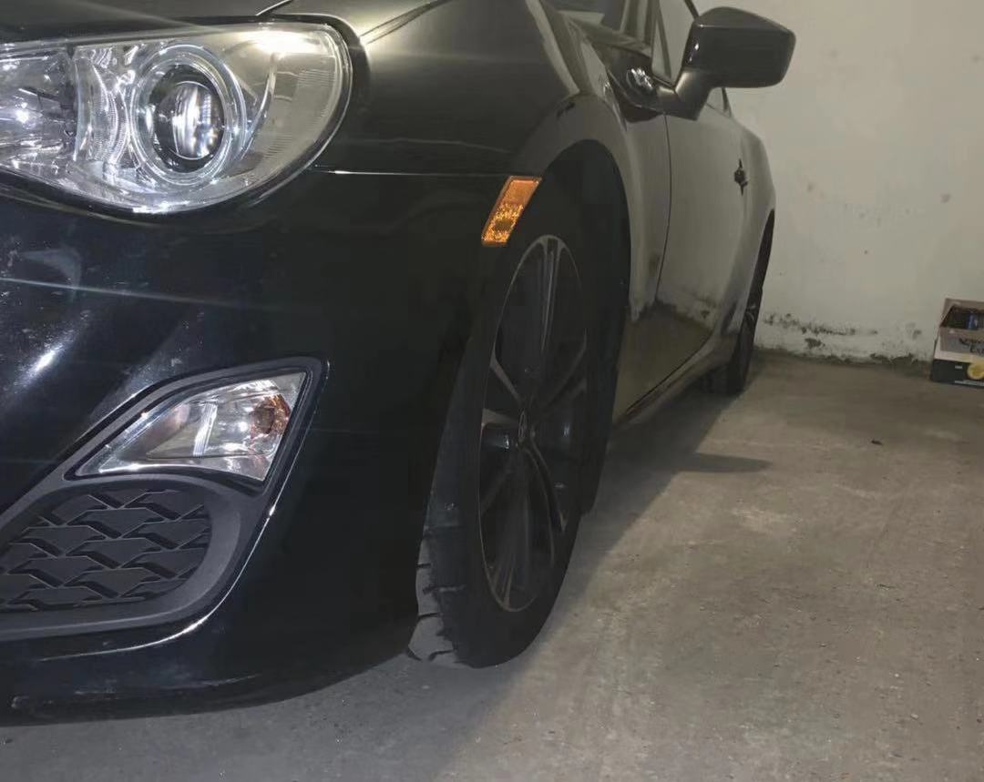

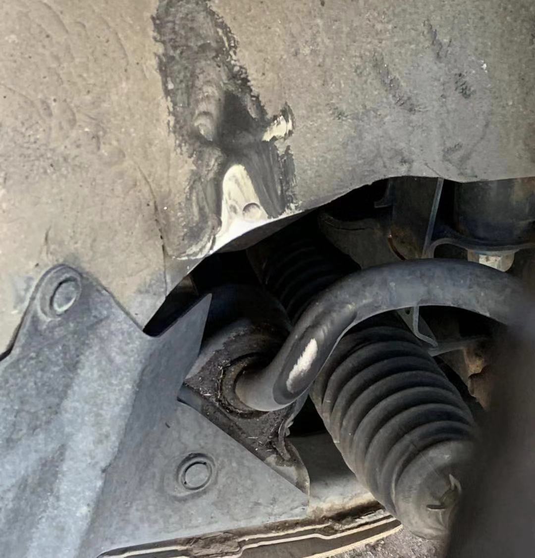

Hi, I just installed my MCA red series coilovers.
I got tire rubbing the sway bar and frame on the front. My car is running stock rim ,225/45/17 re71, stock height, -3 camber front. Running stock rim, should not rubbing. Anyone has same issue? any advice?
Thank you.
Attachment 179796
Attachment 179797
Attachment 179798
Attachment 179799
Attachment 179800
Skyehigh55 07-24-2019 01:45 PM
Run spacers (10mm or so) to push out that high offset the stock wheels have (+48) or fix that camber from -3 to possibly only -1.5 all around. I wouldn’t want to be running -3 camber at stock height with a +48 offset, since the wheels are sunken in enough already. That’s my $.02 why you’re running into rubbing issues but hopefully someone else can chime in more.
Your stats check out on http://www.ft86motorsports.com/wheelitfit/ so hopefully someone helps!
maslin 07-24-2019 01:53 PM
Why should it not be rubbing? Stock wheels are super high offset. You also added a taller and wider tire, -3* of camber and lowered it an inch +. That's not stock height, not even close.
Of course its rubbing.
Take some camber out, raise the car up, get wheels with proper offset or get smaller tires. Lots of options.

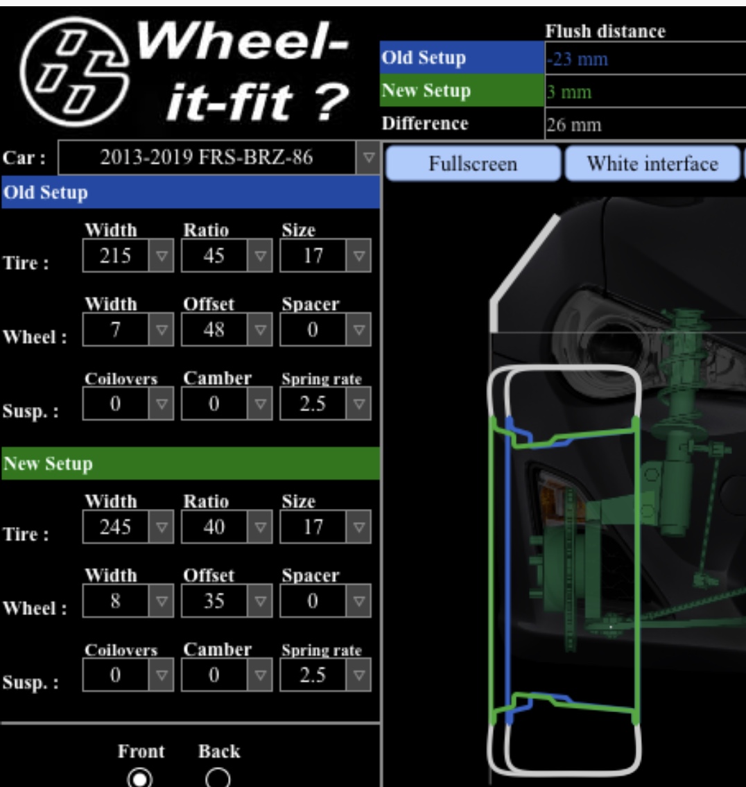

Attachment 179811I run -3 camber because this car is mostly track use. I am new on track, so I start 225 to practice. I am afraid of even I get small ET( like 35) wheel, still has rubbing issue. same distance between wheel and frame.
maslin 07-25-2019 12:06 AM
You’ve neglected to include any lowering in that calculation, as well as camber.
A 225/45 is taller than a 245/40.
It’s clearly rubbing. You have a taller tire on a very high offset wheel, with a lot of camber a bit of a drop. One or more of those is going to have to give.
