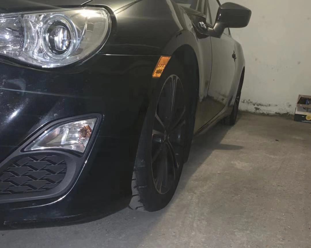

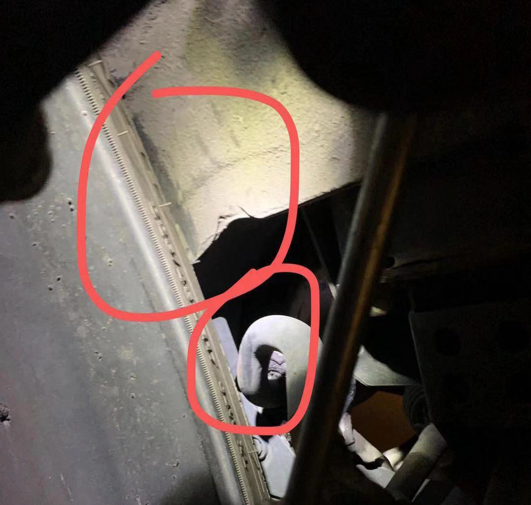

Hi, I just installed my MCA red series coilovers.
I got tire rubbing the sway bar and frame on the front. My car is running stock rim ,225/45/17 re71, stock height, -3 camber front. Running stock rim, should not rubbing. Anyone has same issue? any advice?
Thank you.

Leonardo 07-24-2019 01:04 PM
I would add a spacer or decrease the amount of camber you have. Bolt on spacers are easy to install, will flush up your OEM wheels, and will not modify your car permanently. I'd suggest 25mm front and 30mm rear.
Then, Get an alignment!

maslin 07-30-2019 01:31 PM
You started a second thread with the exact same title hoping for magical different answers?
You have high offset wheels, wide tires and a ton of camber. Fix one or all and it won't rub. This isn't hard to understand.
