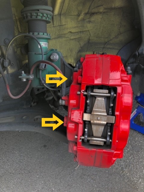

3. Turn the steering wheel to the side being worked at to point the caliper outwards from the wheel well.
Attachment 178791
4. Remove the brake line hanger screw using the 1/4 in. drive ratchet with a 12 mm socket. This is done to allow the caliper to be set down on the floor in the next steps and prevent it from hanging off the brake line.
Attachment 178792
5. Loosen the two (2) caliper bracket bolts using the 1/2 in. drive breaker bar with the 19 mm socket. Then remove them by hand (Use the 3/8 in. drive ratchet with the 19 mm socket if necessary). *1/2 in. drive ratchet is too large and will interfere when removing the top caliper bracket bolt with another bolt (red circle) when removing. Even when using the 3/8 in. drive ratchet there is a point where interference will occur and the ratchet needs to be removed to continue unscrewing by hand.*
Attachment 178793
Attachment 178794

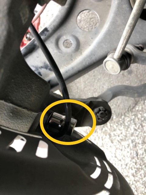

8. Remove the speed sensor bolt using the 1/4 in. drive ratchet with a 10 mm socket and pull it out by grabbing onto the sensors plastic casing. Do not rotate the sensor as it has plastic tabs that help orient it and do not pull on the cable to prevent any damage to it. (I placed the socket on the bolt to help visualize where it is)
Attachment 178796

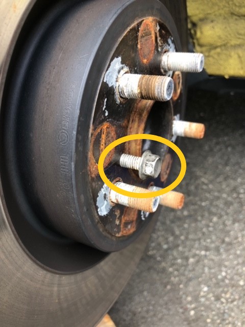

9. Remove the four (4) hub bolts using the 3/8 in. drive ratchet with a 14 mm socket. (Use the 1/2 in. drive breaker bar with a 14 mm socket if necessary to loosen the bolts.)
Attachment 178797
10. Remove the factory 5x100 hub. Use the hammer to gently nudge it if it gets stuck when pulling it out.
Attachment 178798

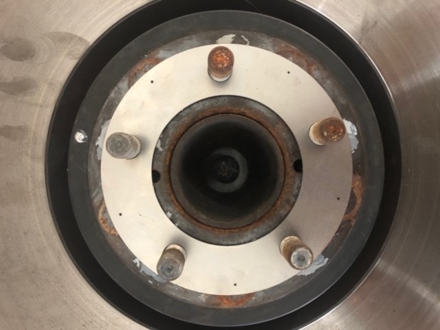

12. Assemble the factory hub and rotor.
13. Place the provided template on the rotor using the studs as guides.
Attachment 178799
14. Adjust the drill press to allow the assembly to fit. I did not have a punch that would fit through the guide holes for the 5x114.3 pattern in the template so I created pilot holes with the 1/16 in. drill bit.
15. Use wooden blocks to slightly elevate the hub and rotor assembly while keeping it level. This will make the assembly more stable since it will not allow it to pivot on the hub
16. Install the 1/16 in. drill bit in the drill press.
17. Align one of the guide holes with the 1/16 in. drill bit
18. Clamp the assembly down to prevent it from moving. If using metal clamps place a thin piece of wood or card board between the clamp and the rotor to prevent metal to metal contact and damage to the rotor.
19. Using the 1/16 in. drill bit, drill through the guide hole on the template and about 1/8 in. deep into the rotor.
20. Repeat steps 17 - 19 for the remaining 4 guide holes.
21. Remove the template from the rotor.
22. Disassemble the rotor from the hub.
23. Place the rotor in the drill press and adjust height if needed. (I decided to go ahead and make through holes with the 1/16 in. drill bit. to better guide the next one but it is not necesarry)

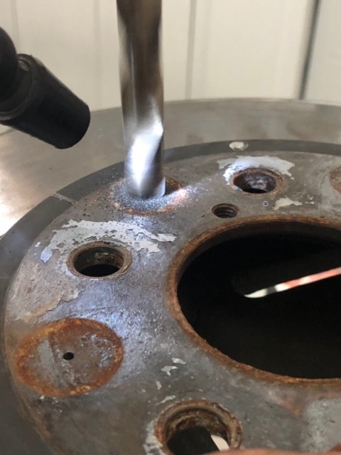

24. Install the 1/2 in. drill bit in the drill press
25. Align one of the pilot holes with the 1/2 in. drill bit
Attachment 178801
26. Clamp down the rotor to prevent it from moving. If using metal clamps place a thin piece of wood or cardboard between the clamp and the rotor to prevent metal to metal contact and damage to the rotor.
27. Using the 1/2 in. drill bit, drill through the rotor hat.
Attachment 178802
Attachment 178803
28. Repeat steps 25 - 27 for the remaining 4 pilot holes.

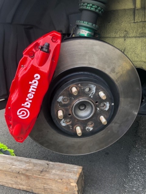

39. Install the rotor. Make sure it seats properly and evenly.
Attachment 178805

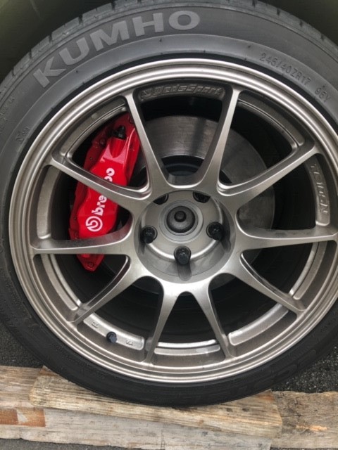

47. Install the wheel.
48. Screw in the lug nuts by hand to prevent cross threading.
49. Tighten and torque to 89 ft-lb (OEM Spec) in a crisscross pattern. (No more adapters!!!)
Attachment 178808
Attachment 178809
