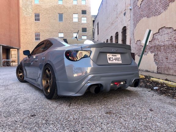

The previous owner had done some minor modifications to it such as a paint job, an exhaust (no idea what it is), a front bumper, a rear defuser, and some taillights. Other than that, the vehicle was stock.
Everybody knows that once you buy a new car you have to go take shitty iPhone pictures of it somewhere.

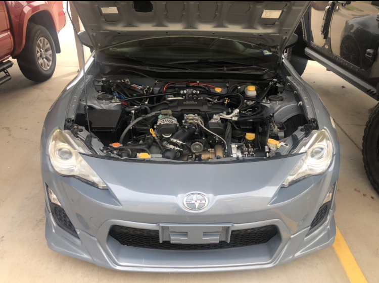

Got the hot and cold side mocked up, nothing is tightened down fully.
Attachment 178724
Attachment 178725
It took me the a week but the kit is completely installed! I am waiting on the ECUtek tuning package from DeliciousTuning to get here next week. I am going to leave the bumper off for now so I can check for leaks once I start it. I’m so pumped. :happyanim:
Attachment 178726
She's up and running! I'm currently working with the guys over at Delicious Tuning to get a few maps set up and fine tune the power levels. I'll try and get a sound clip/pull when the tuning process is complete.

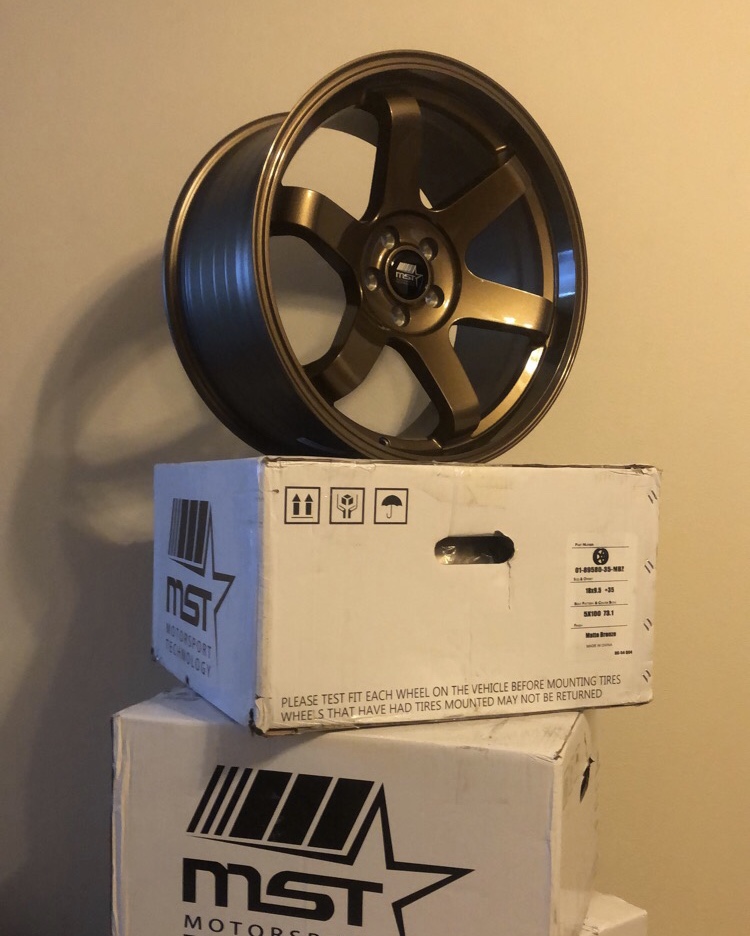

After some Q&A and a lot of scouring of instagram and other websites, I decided to go with a set of MST MT01s 18x9.5.
Attachment 181252
Attachment 181253
I suppose this explains the vibrations I was feeling at around 80 mph! This could have ended badly...

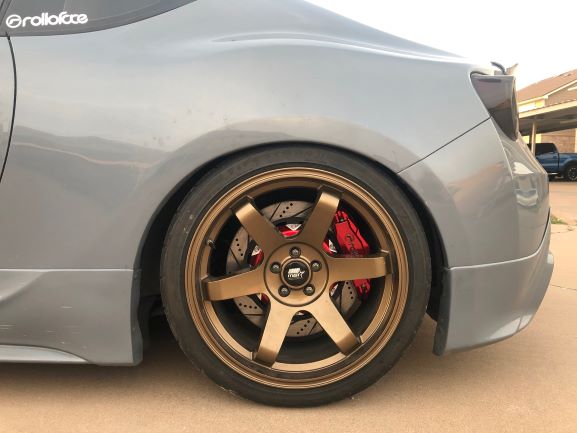

This is probably my second favorite modifications to the FRS, second to the turbo kit. These took my quite a long time to acquire but I am so satisfied with how they look and perform. The front is a six piston caliper on a 2-piece 345mm floating rotor while the rear is a 4 piston caliper also on a 2-piece 345mm floating rotor. I ordered them both in a "deep red" color which is hard to fully appreciate with an iPhone camera.
Attachment 189329
At first I wasn't sure if they were actually going to fit under my wheels.
Here is a picture of the new front rotor compared to the stock rotor.
Attachment 189330
Unfortunately I do not have comparison for the rear set.
Attachment 189331
The car stops incredibly well. Even with the turbo kit, these brakes are overkill for this car and I love it.
