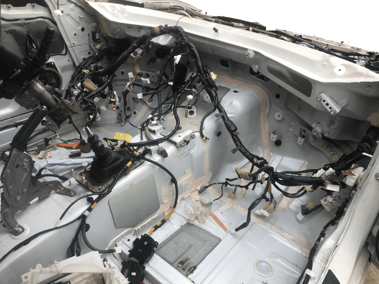

Also, so I believe this car was a rollover. However, the worst part is that someone at the auction ripped off the window protective stickers to take a look inside and it was raining then. When I got it, there was about an inch of water in the car. I didn't provide power since I got it prior to gutting and cleaning the whole thing. Including opening every module and cleaning it with isopropyl alcohol and brush.

Are Kirkeys, an LS and Motech an option? Probably the easiest way to bring that back.
And I found your power issue. Everything is unplugged.
Seriously though. If that's the current condition, you aren't in a place to check anything. Assuming the car has been reassembled to a significant degree... Power and ground. Everywhere there should be power and ground. That's step one. After you've established constant and switched power, check CAN. From there, you're ruling out modules.
I watched a guy dump $80k in to a flood salvage S550. It left our shop the same way it came in, on a roll back. He had "disassembled and cleaned" the modules as well. They were all dead, along with the chassis harness. My $40k quote ran him out the door. He could have bought a nice running car for $50k at the time.
I suspect you will surpass the price of a running BRZ well before it ever moves and passes an inspection. Good luck, looks like a track toy to me at this point.
