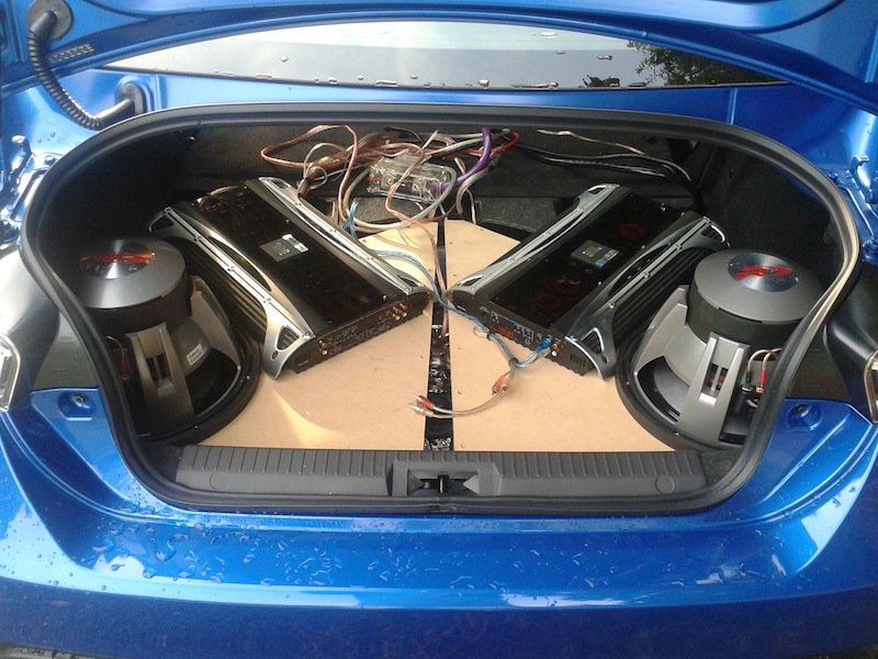

I just added my JBL PX300.4 to the stock speakers and it sounds pretty good. Quality is crap (I'm coming from Focal components w/ an Alpine DSP) but it's loud and the distortion is minimal. Compared to stock it's 100x better. But I'm coming from my previous build of a computer with digital audio, an Alpine DSP, Focal components and 2 12" Alpine's in a ported enclosure.
Now I just need some bass in this BRZ (and some new front speakers). I was thinking about fiberglassing a 12" sub (maybe two) in the spare tire well. Once my dynamat gets here I can get started.
I'll keep you all posted.

8/7/2012 - Trunk preparation
My Alpine Type R's are too deep - I'll be using the spare tire well but I'll be inverting the subwoofers in the far corners of the trunk rather then mounting the sub directly into the well.
I uploaded some pictures of the sound deadening in the trunk and the preparation of the sub box ...still much more to do

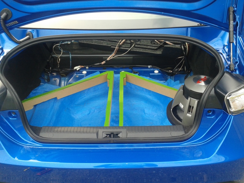

8/8/2012 - Fiberglass frames are ready
I created the fiberglass frames this morning for the subwoofers - cake walk but now I must wait because the weather is horrible today. The plan is still the same - inverting the subs firing down into the corners. But, I was also thinking that I could also (later down the road) put shallow mount subwoofers here and have even more trunk space. Should the need arise it's good to have that option. pics below.

8/9/2012 - First layer of fiberglass
I was able to test fit the frame today and start the first layer of fiberglass. Once this layer cures I can pull it out, clean it up, and layer on some more with it out of the car.
I also put a picture up showing why mounting them straight into the well would not be best. I'd either have to raise the floor (which from the factory is already high) or use some rings and mount the subs on an angle. I think the corners are going to work best. See below for new pics.

8/14/2012 - In and pounding
I just had to wire it up and take a listen ...it pounds and sounds fabulous. I took one of those crappy youtube videos.

rmjjensen 08-07-2012 09:09 PM
I changed my mind regarding the subwoofer placement. The Alpine Type R's I have are way too deep and would take up too much trunk room if I mounted them in the spare tire well.
Instead, I'll be using the spare tire well as air space and invert the subwoofers into the false floor. Since they're being inverted I'm going to mount them into the far corners of the trunk.
That's the plan!
