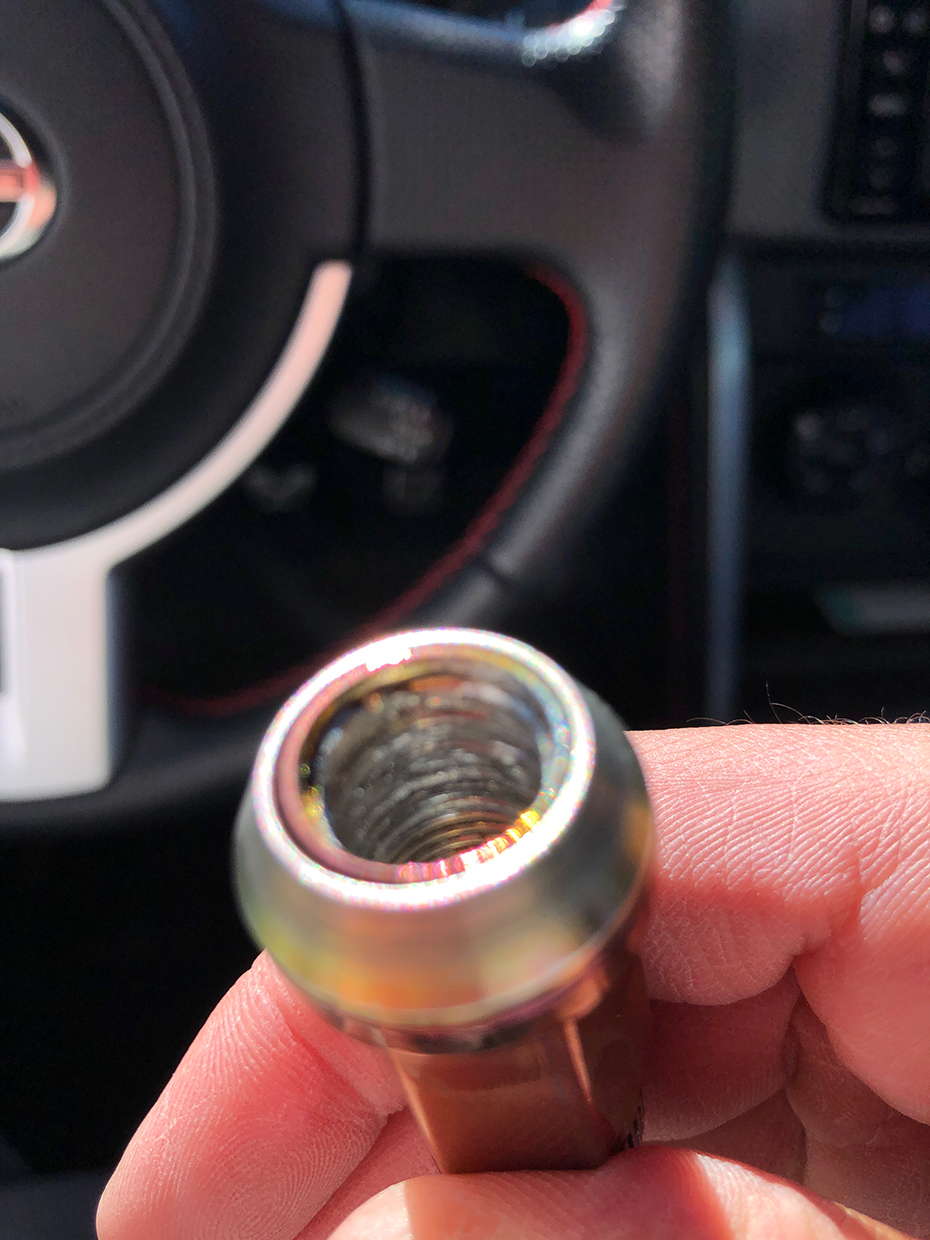

So I was installing my coils and during the install, I found almost 8 stripped and 2 broken studs. I got my wheels and new sr48 lugs mounted about 6 months ago from a pretty reputable shop. I know the oem studs aren't the best but never had this issue on my other cars, would it be due to bad install and how to prevent it in the future?

It's a combination of shitty lugs, weak studs, and over torqued. To pin point the actual cause, eh? Who knows. Could be one or could be all three.
Just get some nice apr wheel studs and move on.

That looks like it was cross threaded and forced, probably just impacted on.
Averaging 40+ wheel swaps a season and I've never had issues... While the stock stuff is clearly not the best, it takes work for it to be as bad as this.
89lb/ft. 80 is too low and could cause issues. Also maybe an accidental typo but just in case this is randomly referenced by someone...
I've watched shops do this and cringed every time. You hand thread it first, then use the impact.
OP: You're going to have a hard time proving anything at this point, but use the opportunity to get APR studs and put them in yourself or if you have to, find a more reputable shop to help you.
Two real issues:
1) the shop probably didn't clean the threads + hand thread the lug nuts to prevent contamination/cross threading
2) SR48 are open ended lug nuts, you need to make sure the threads are clean before you install them
Minor dirt or contamination on the threads of an open ended lug nut can lead to premature failure of the stud. A simple wipe of the threads with a towel usually is good enough, but most people (and shops) don't do this at all when installing new open-ended lug nuts.
