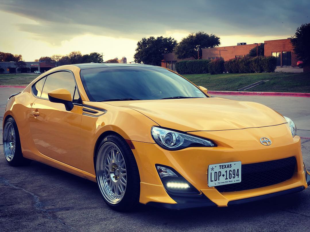

What's the difference between OFT and Ecutek (pro's and con's). Pics below.
Attachment 172425
