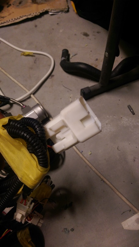

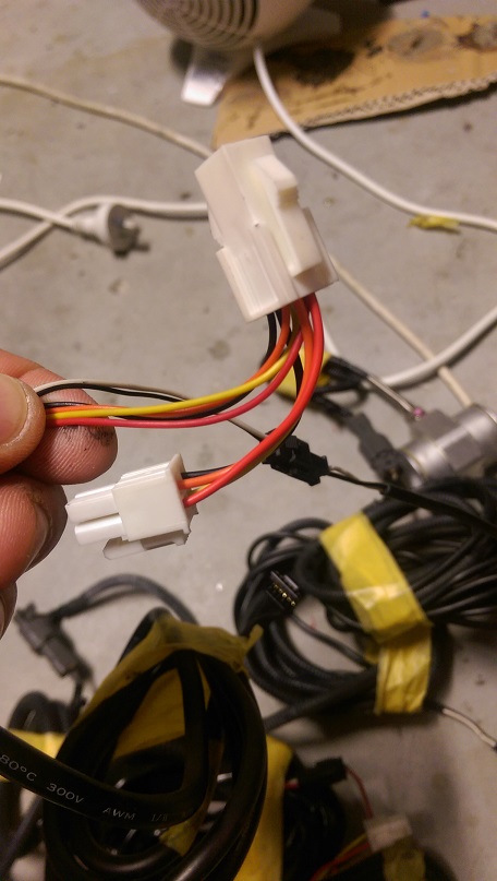

Here are the terminal ends that confuse me. Any help would be greatly appreciated.
Attachment 171707
Attachment 171708
Attachment 171709
Drakiv 10-18-2018 12:44 AM
isn't there a controller for those guages? I think it's called a Live unit 2 or something that the guages plug into.
Edit: I found this....don't know if these are the guages you got or not.
http://www.manualsdir.com/manuals/ge...f6b8c58&open=1

KnightRyderx2 10-24-2018 12:53 PM
Not sure if you were to get this installed but here is a couple manuals I found. I could only find it in Japanese. I used google translate to read it and from what I gather those are continuous 12 volt, ignition 12 v, illumination, and ground. I'm not sure if you have everything for it but from what I can understand in the manual you only need one connection to the power/illumination source and you can daisy chain the rest together. There is also a manual on the GT86 gauge mounting and wiring, that is the second link. From what I can understand you can use a 15 pin connector located under the drivers side dash by the steering column and blinker relay for all the power sources.
Racing Meter SD manual
Racing Meter SD set for GT86
panel install
