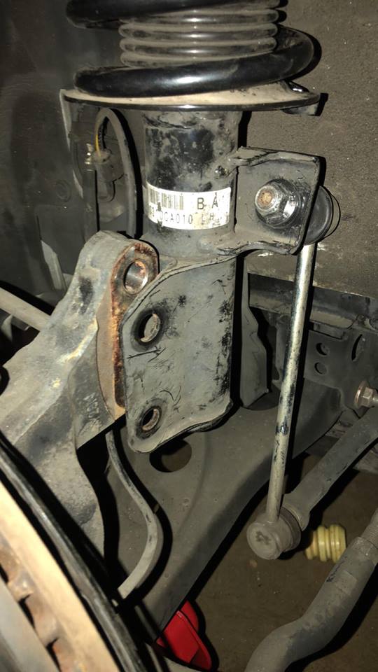

Basically, when I install the strut back to the top, I can push the hub back into it, but the endlink (?) is short by a few inches. Photos will be coming asap. Thanks !

That's cause the other side is pulling on the sway bar. Get the other side in, then they'll be even and you can hook the endlinks back up.

LeonardoDaVinny 09-03-2018 03:32 PM
Originally Posted by Yoshoobaroo (Post 3129024)
Post some pictures of where it's not lining up, that way those of us who are 2000 miles away can try to help too [emoji6]
Attachment 170060
n0thing 09-03-2018 03:39 PM
Push the knuckle down and insert bolts?
LeonardoDaVinny 09-03-2018 03:49 PM
Thats as far as it goes
Yoshoobaroo 09-03-2018 03:53 PM
Undo the sway bar link, bolt the knuckle up, do the other side, reattach the sway bar.
