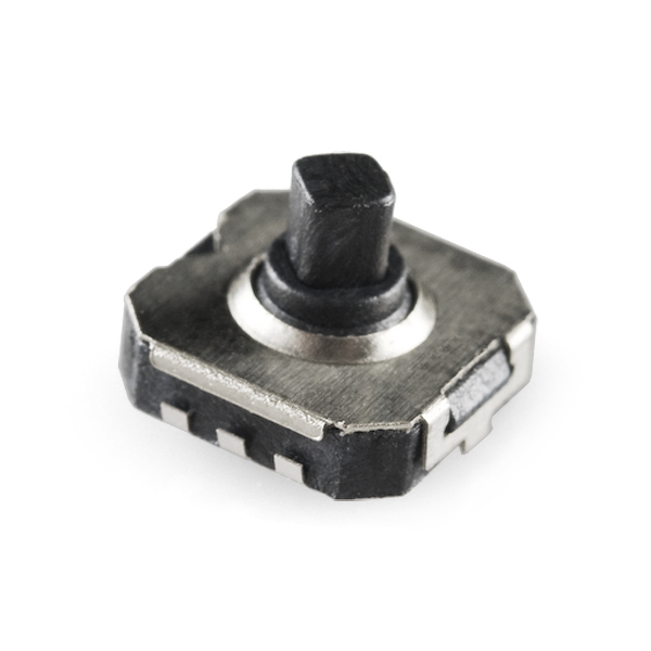

Im also thinking of using tese small 5way directional switches.. but there will be a extra button for the "back button that needs to be there as a second thing.
https://www.adafruit.com/product/504...BoCWH4QAvD_BwE
