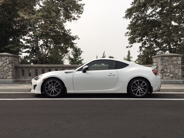

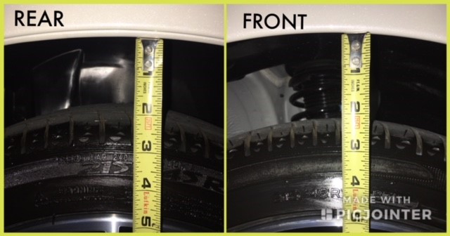

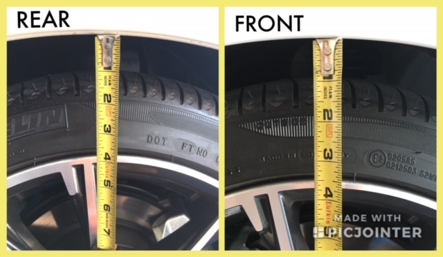

I searched around here looking for some members with HR Springs and seems not too many people have gone with them. I chose HR because I have a lot of success and experience with them even tho it's mostly BMW's. All H&R products are 100% made in Germany and exceed ISO quality assurance standards. They have TÜV certification as well of course. I have all the products and options listed below.
I briefly toyed with the 0.85" drop but thought it was too subtle. Given how large the OEM wheel gap is, I thought 1.4" would be pretty safe. I've included some closeups of the BEFORE and AFTER wheel gap. With the shorter bump stops the relative travel is maintained and the ride quality is very close to OEM. The turn in is noticeably sharper and the car still swallows up the little bumps without unsettling the car. The roads are pretty good around here so no big potholes to speak of. I'm looking at HR spacers next. Just need to decide which width will work best with the OEM wheels. Here is what the end result looked like.
