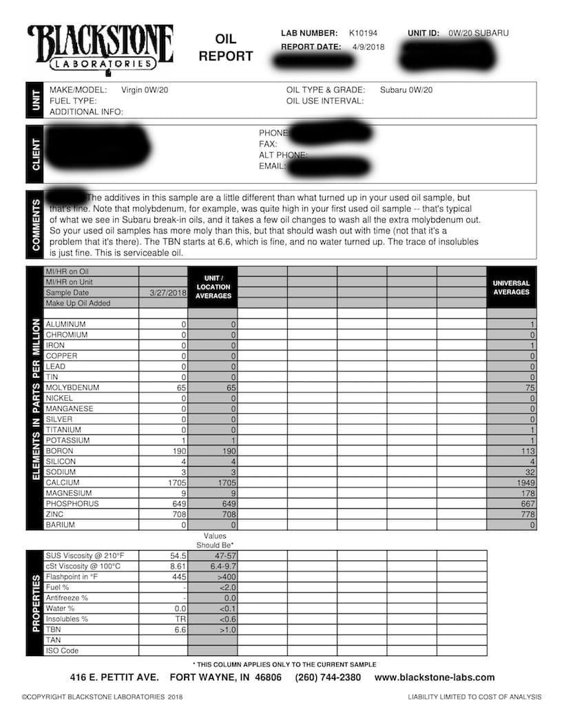

Howdy Folks,
I wasn't sure if anybody would find this interesting or not. But just in case I figured I'd share here. Along with my used oil after my first track session I sent a sample off to Blackstone Labs of virgin OEM oil straight from the jug (PN: SOA427V1315). Here's the report:
Attachment 165112
I'd be curious how this compares to virgin full synthetic oil from other manufacturers (specifically Mobil 1 and AMSOil). I may buy a few quarts and send off samples just to see.

Thank you for the VOA.
http://pqiamerica.com/PCMO_Sample_Su...2_15_2016.html and https://www.bobistheoilguy.com/forum...sis_-_PCMO/HDE may save you a couple of bucks.
