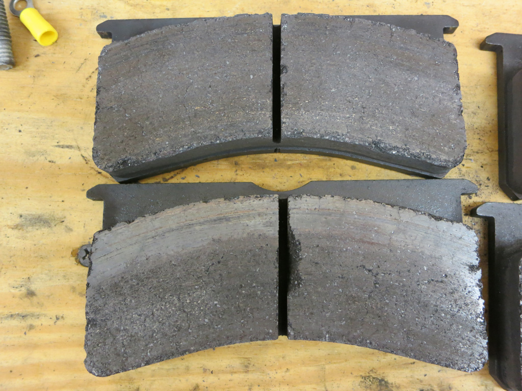

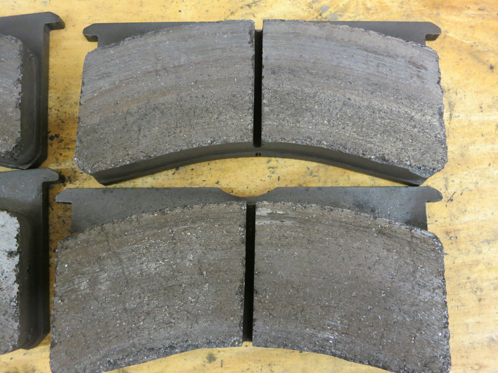

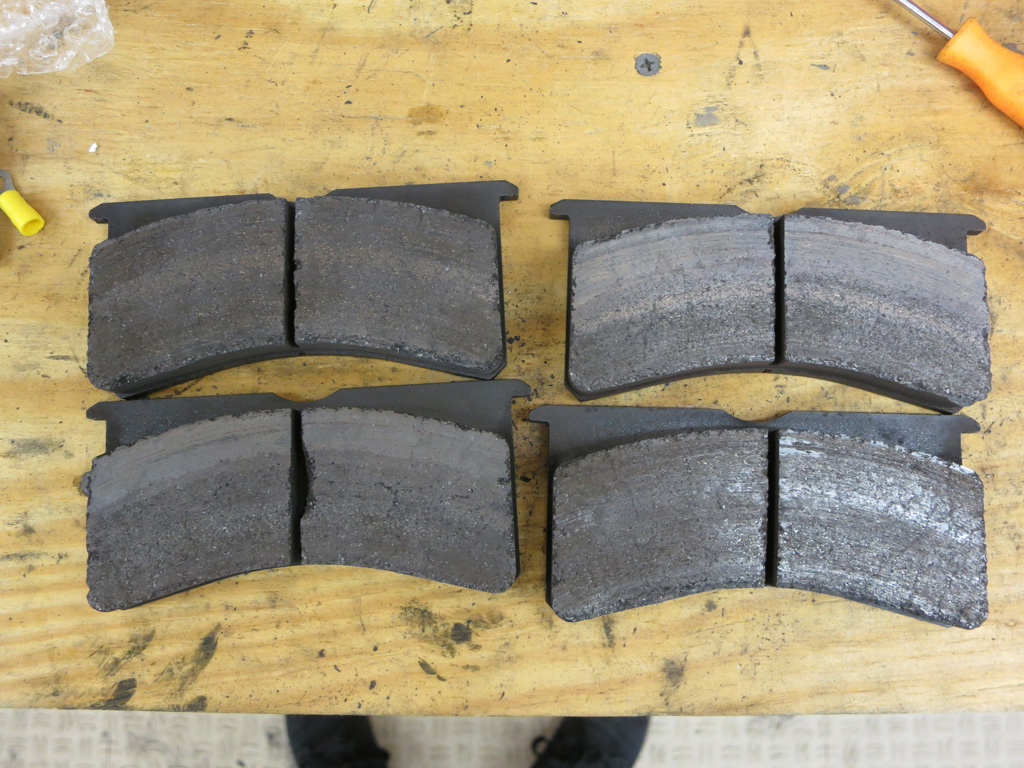

I'm currently using the AP C300 front pads. These things are LOUD on the street by the way so when/if you buy this kit GET SOME STREET PADS ALSO! FWIW, the AP S100 pads also make some noise on the street so if you want it to be completely silent I'd suggest talking to @JRitt about other street pads that will be more mild than the AP S100 pads. Anyways, back to the C300s. Below are some pics of the pads after the usage they've had so far, the crumbling on the edge of the pads isn't anything to be concerned with. I am getting some minor cracking closer to the backing plates that I am monitoring for now. Jeff Ritter will actually see the pads in person next month as I'm stopping by Essex to say Hi on the way to a friends shop in Charlotte.
http://www.itrexpo.com/users/dave/brz/IMG_0080.jpg
http://www.itrexpo.com/users/dave/brz/IMG_0081.jpg
http://www.itrexpo.com/users/dave/brz/IMG_0082.jpg

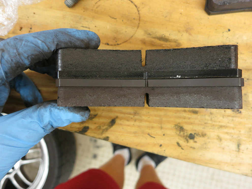

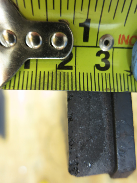

So far I've experienced about 1mm of pad wear on the trailing edges and about 2mm of pad wear on the leading edges. The worst pad experienced 3mm of pad wear on the leading edge (it was the only one), as seen below:
http://www.itrexpo.com/users/dave/brz/IMG_0079.jpg
Here's a new S100 next to the used C300:
http://www.itrexpo.com/users/dave/brz/IMG_0078.jpg
Pads in the calipers before removal:
http://www.itrexpo.com/users/dave/brz/IMG_0074.jpg
http://www.itrexpo.com/users/dave/brz/IMG_0077.jpg
So, it's looking good so far! For comparison I used at LEAST 5-6mm on Carbotech XP10s with similar usage plus an extra 30 minutes or so at Mid Ohio (where I wasn't pushing much) and a lot more street mileage, which kills rotors well before track pads.

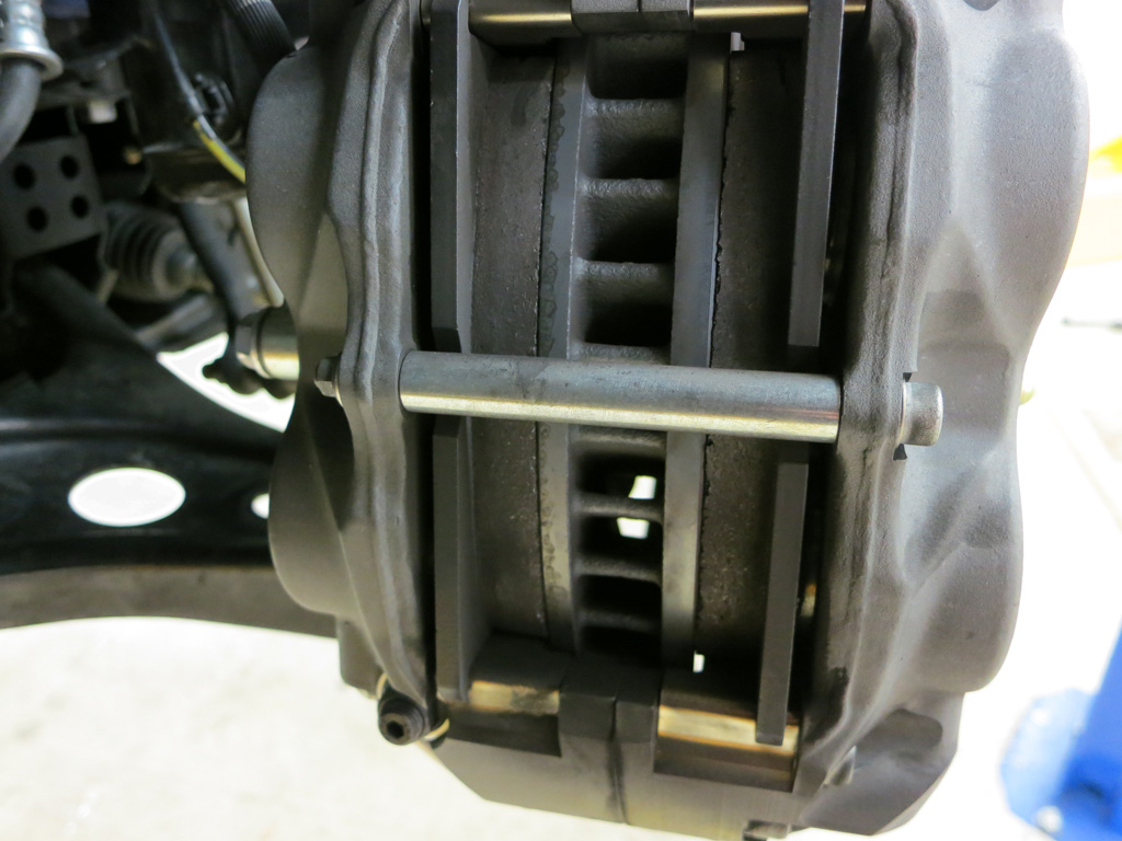

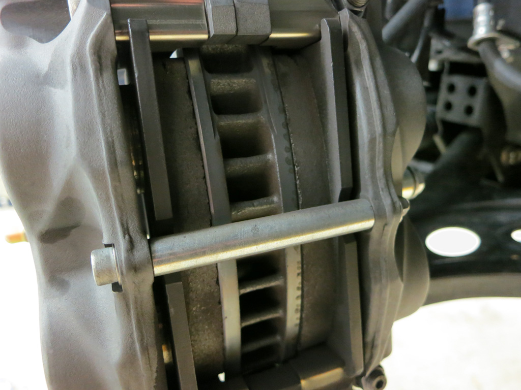

Rotors:

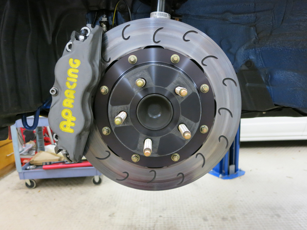

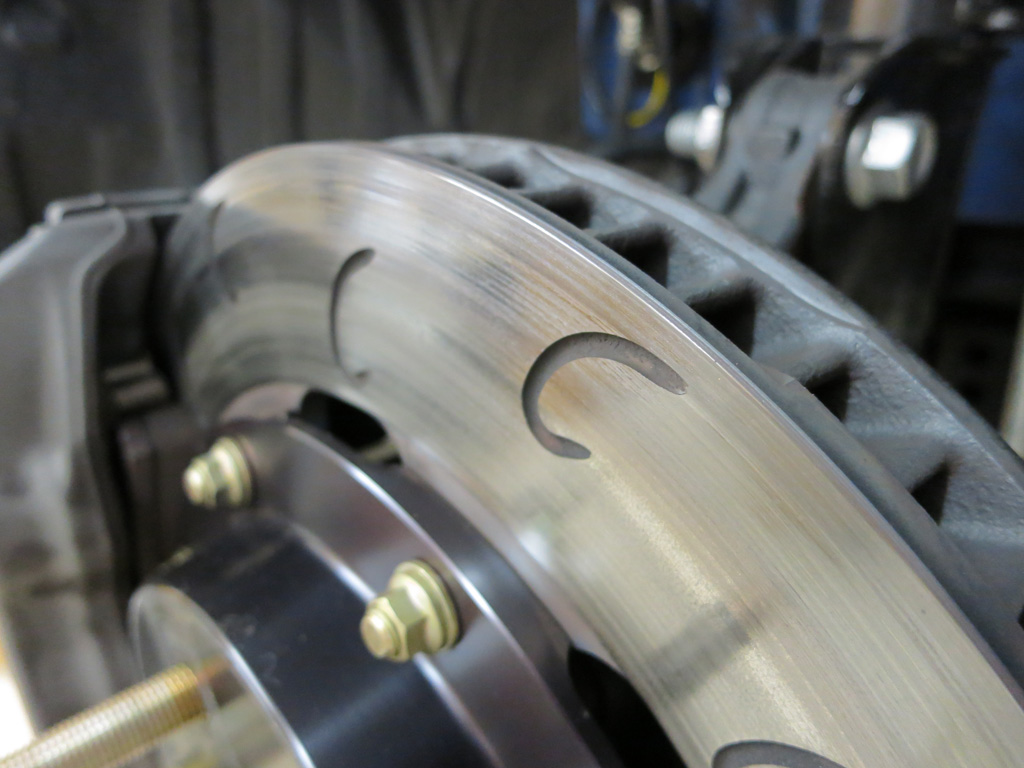

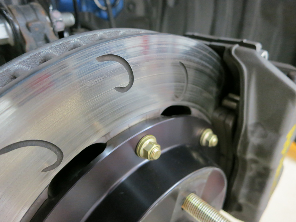

I didn't measure the rotors, but they appear to have virtually no wear. There are no lips, uneven wear, grooving, etc. And unlike my OEM rotors, no surface delamination either :)
Passenger Side:
http://www.itrexpo.com/users/dave/brz/IMG_0071.jpg
http://www.itrexpo.com/users/dave/brz/IMG_0072.jpg
Driver Side:
http://www.itrexpo.com/users/dave/brz/IMG_0075.jpg
http://www.itrexpo.com/users/dave/brz/IMG_0076.jpg
