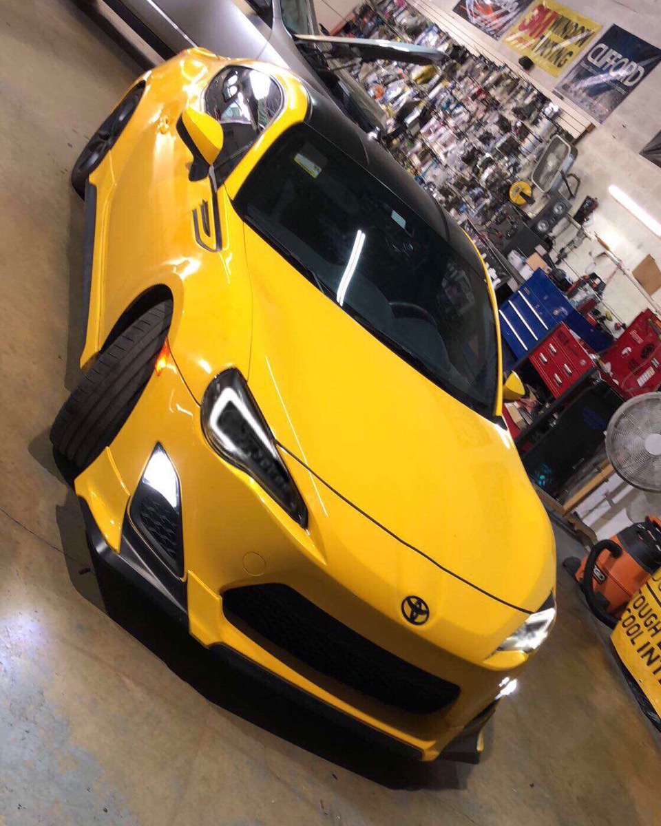

These are the oem headlights from a 2017 BRZ which I had the housing blacked out

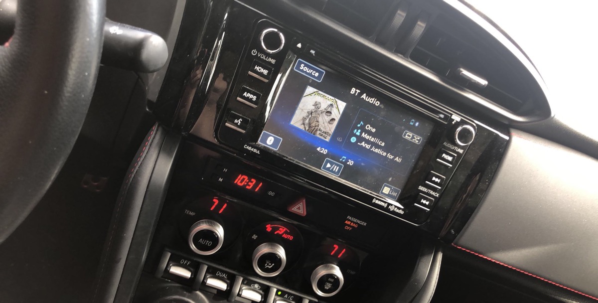

2017 oem Brz radio with faux carbon ac controls

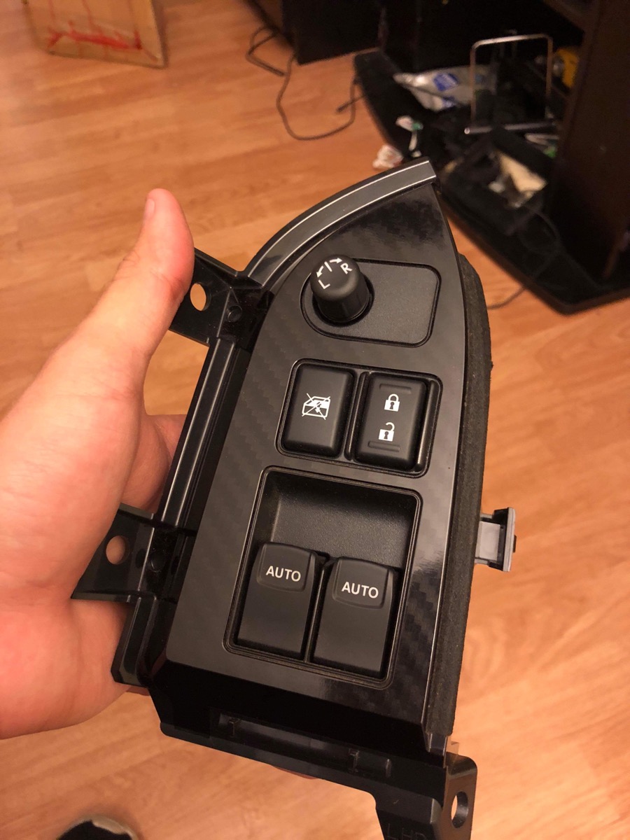

Same faux carbon on door switches from 2017 brz

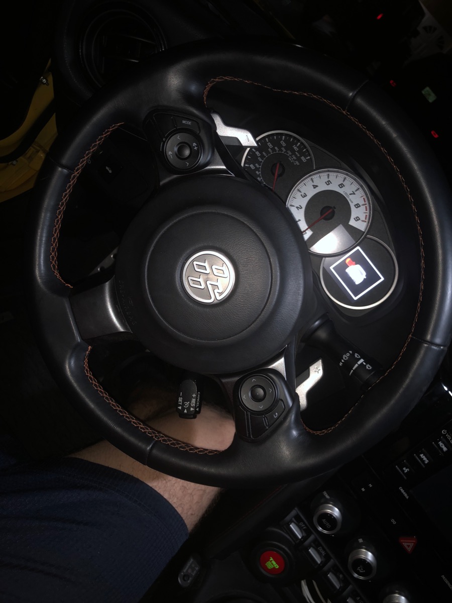

2017 860 steering wheel and air bag Which I hope to have the steering wheel restitched in red, or yellow if I manage to find the seats I want for sale, but here you can also see the gauge cluster as well

Now that 2018 brz came out and seem to have an upgraded headunit I’m going to try to get my hands one on for my car in the near future

Nice work!!. I’m interested in the gauge cluster swap. I have a 17 86. Where did you get it, what’s the part number? How much?. How did you go about getting it programmed?. Same with the steering wheel buttons. Part number? Did you have to buy a harness?.. Do share!

Looks dope so far! Did you have any trouble fitting the new headlights in? I have a ‘14 brz and I want to get the new headlights too

I among a ton of other people are going to be interested in the Gauge swap. I know clock spring needs to be changed for the steering wheel. What exactly needs done for programming the cluster? Does the car need to be available (Mine is currently apart for engine rebuild and upgrades), also are the steering wheel controls working?
jorgerendonjr 03-08-2018 02:09 AM
Yea steering g wheel controls all work and yes that did require the 2017 dash harness and 2017 oem clockspring
Ask far as the cluster swapping goes, it’s only able to be one on push to start veihicles due to an immobilizing mechanism that key start cars have
For the programming the dealership did it for me and also sourced the parts, the wheel set up and cluster you’re looking roughly at mid $2,000 USD after all said and done

For the switch i found this part number:

This build looks great! I am interested to know how to managed to wire in the headlights. I was thinking of swapping in 2017 BRZ headlights on my 2013 BRZ.
