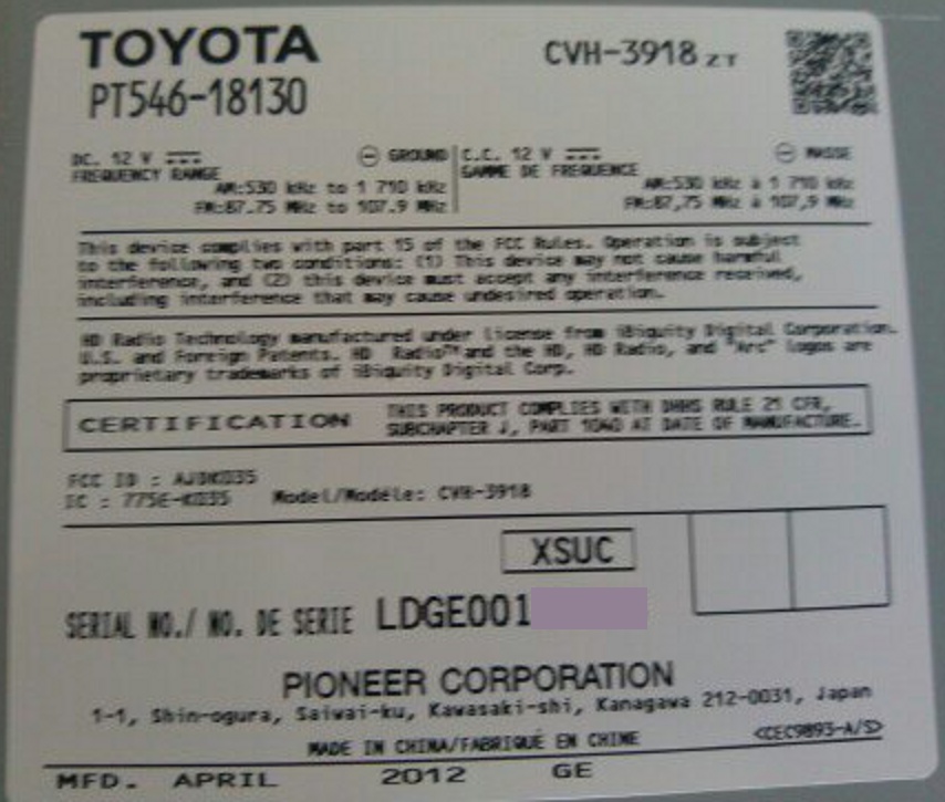

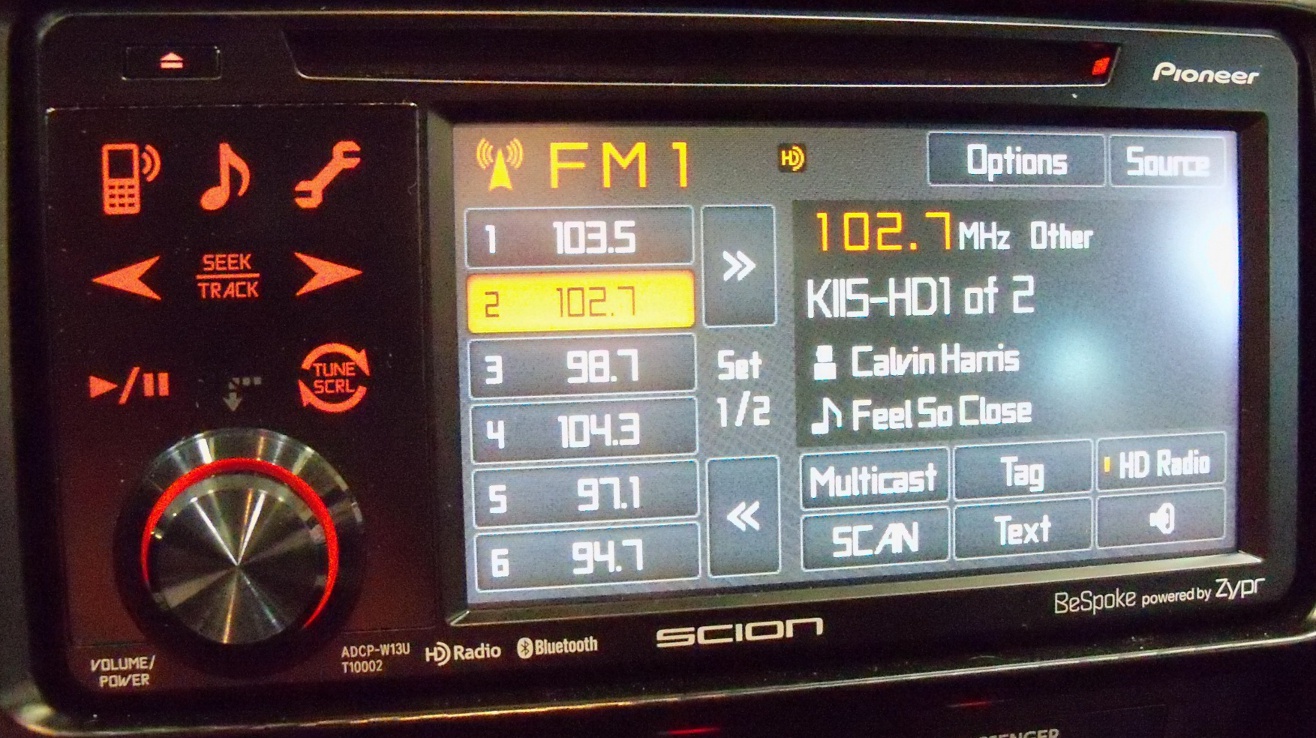

Here are a couple more pics so we'll have a complete set:
Attachment 11086
Attachment 11087
Model numbers:
Front: ADCP-W13U T10002
Toyota Part Number: PT546-18130
Panasonic: CVH-3918
FCC ID: AJDK035
BeSpoke owner's manual PDF here.
Nothing useful on the FCC's site for that FCC ID. The internal photos are only the BT module, and the user manual link is just one page saying there is none.
