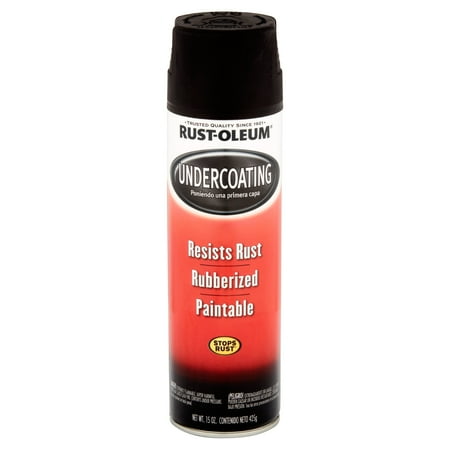

If can't be sen unless laying on the ground I would just use this stuff.
https://i5.walmartimages.com/asr/7a9...0&odnBg=FFFFFF

Got it. Any need to prep the area? And what's the longevity of this stuff? Reapply every year or couple years?
Out of curiosity, is it part of the frame? Or just something that can be replaced as a single piece that just attaches to the frame?

Make sure it is clean and dry . Mask off around it so you don't have over-spray where you don't want it and give it a couple of light coats. It is durable stuff and will last the life of the car (If you don'r scrape again).
The close up pics make it very difficult to tell exactly where it is but I would guess it is indeed structural and would be a pain to replace. No point in messing with it.
