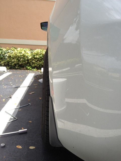

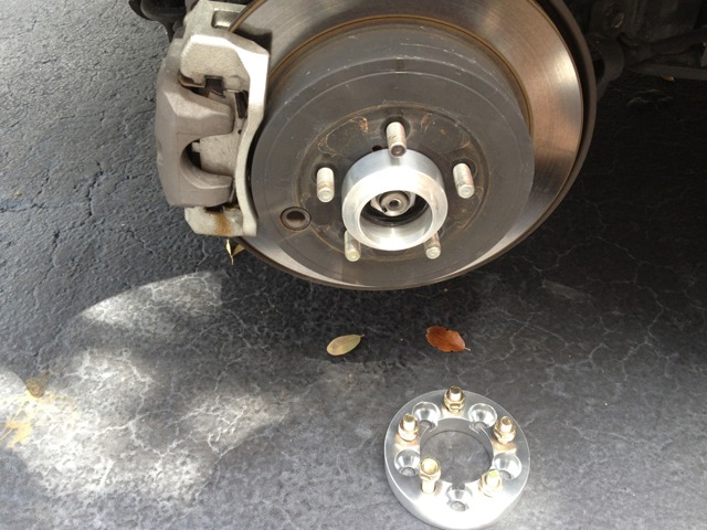

So I bought my sparco wheels and got the factory offset because they were in stock and I wanted my wheels now. Anyhow, slapped em on and lo and behold...
Attachment 10861
So unhappy with the rear fitment results, I opted to purchase a set of spacers for the rear. Pm me if you want brand info or any other questions.
Below I will post pics and some text describing the quick and easy way to get er done.

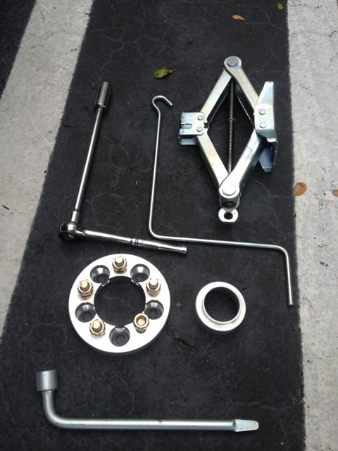

Tools needed.
Attachment 10862

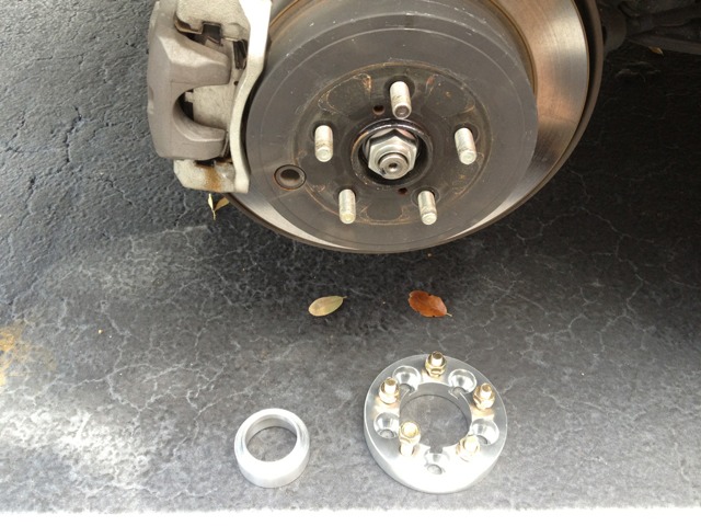

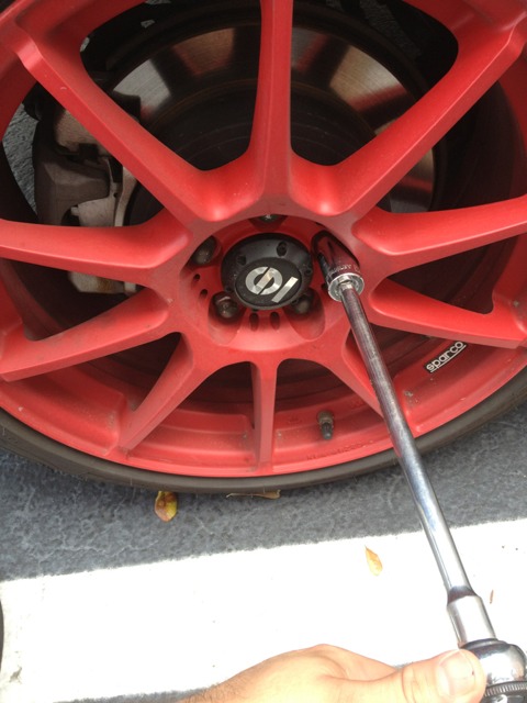

remove wheel after raising car. Pre-loosen lugs so that you don't knock the car over on the stock jack when you completely raise the car. At this point the car is raised enough to lift about 25% of the weight off the tire.
Attachment 10863
Attachment 10864
Attachment 10865

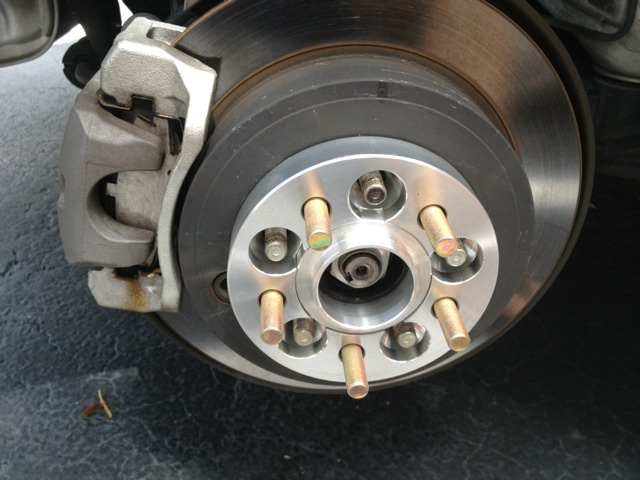

Attachment 10866
Attachment 10867
Attachment 10868
Attachment 10869

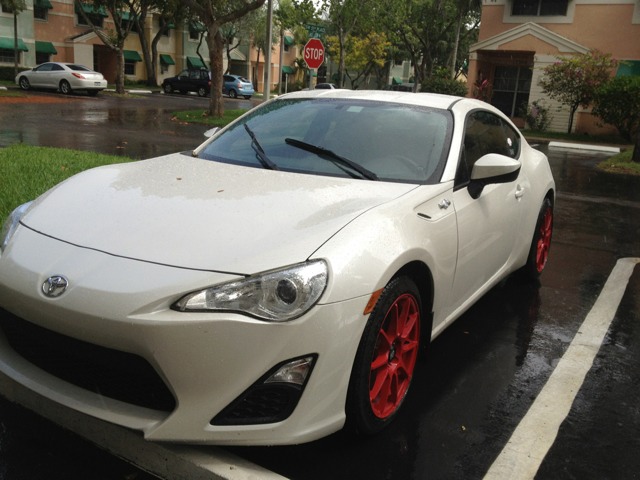

Tada!
Attachment 10870
I know the car needs to be lowered to complete the look. I'm saving up for some tein coilovers. I can't wait :)

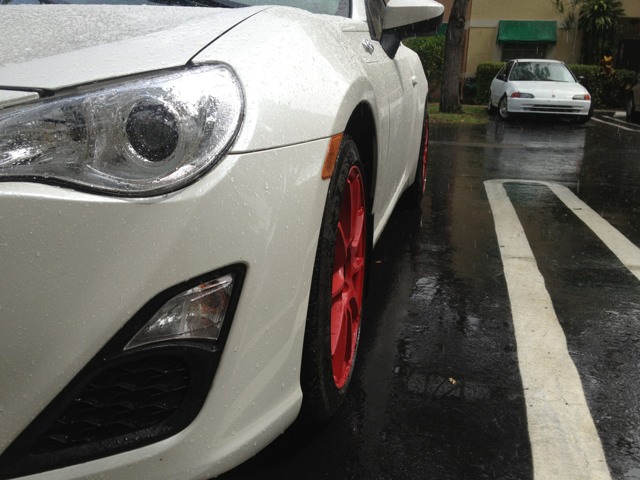

F3dzo 07-21-2012 04:50 PM
Attachment 10871
