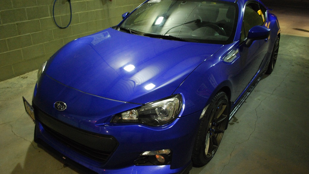

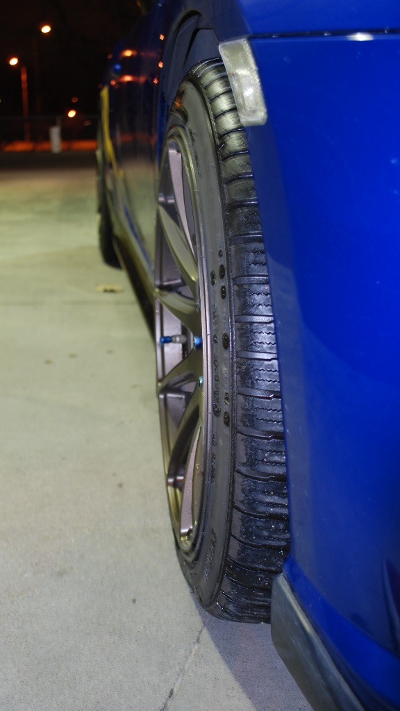

Im running some XXR 527's 18x8.75 with a +35 offset squared. Tires are Sumitomo HTR A/S P02 245/40r18. In my honest opinion, i really like this setup. I was hoping to get as close to flush as possible, with a slight favor towards poke rather that sucked in since i do plan on lowering once i get my coils installed. As far as the tires go, i was hoping for some stretch but nothing drastic. Since i did plan on having a flush and lowered car i did think a little bit of stretch was necessary.
Attachment 160903
As for my specs, while i was a bit skeptical of XXR, i couldn't pass up the price and concave design of these wheels. Their in matte bronze which i have heard others have issues with the paint chipping but i haven't had any issues (im currently about a month into them). They sit flush on the rear and with an ever so slight poke on the front. The Sumitomo tires have been great, i haven't driven them in the winter yet so ill get back to you all on that. As for the specs, there is slight stretching but nothing extreme.

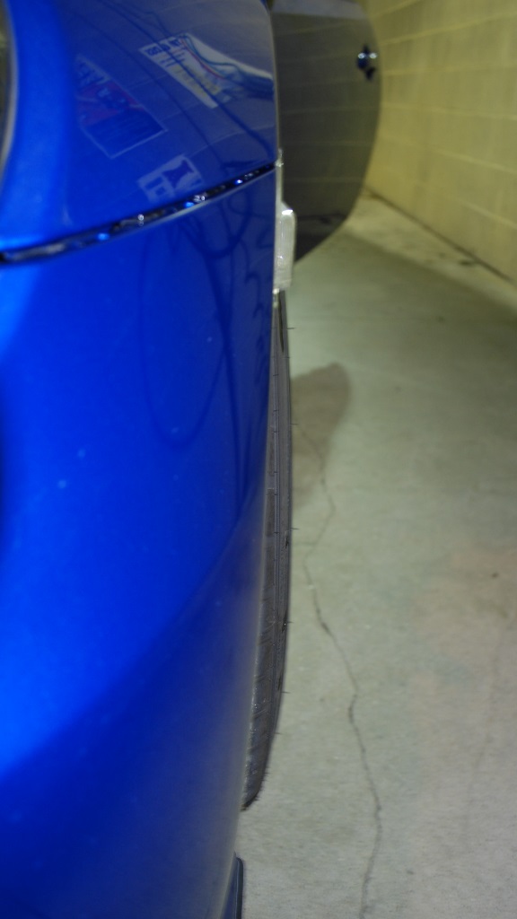

Front
First image is a bit misleading, the poke isn't as far as it seems in the photo.
Attachment 160902Attachment 160906

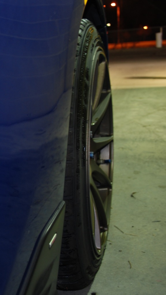

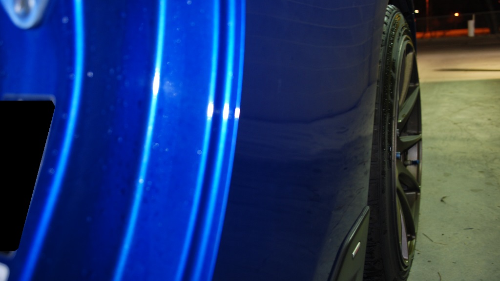

Rear
The rears are about as flush as you can get. I love the look on the rear. Paired with the Rally Armor mudflaps, i think it looks great.
Attachment 160905Attachment 160904

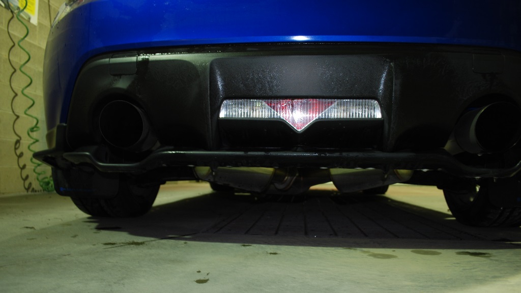

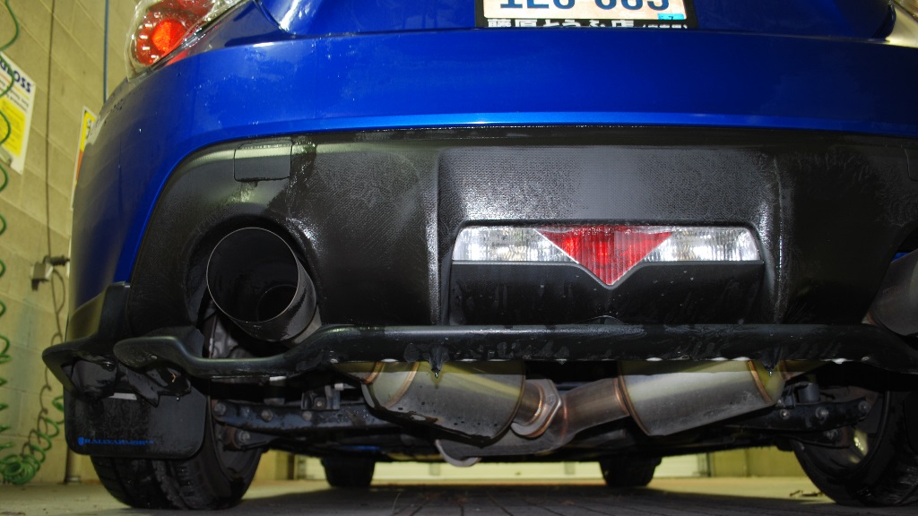

Exhaust
The exhaust is a Greddy EVO GT Cat-back system, its the spiritual successor to the EVO3. Simply put this exhaust is great. The idle tone once the car has warmed up is just what i wanted. It has a very deep and subtle burble. Be warned on a cold start the exhaust is pretty loud. Under load and at wot, the sound is very smooth and you can definitely tell your doing some spirited driving. Cruising, the system is not at all obnoxious. The EVO3 had a lot of complaints about drone but that problem has been solved for this system. During normal acceleration from a standstill, you notice the exhaust but it is not overpowering.
Attachment 160898
My one complaint about this exhaust is the large dual cans. You do lose about an inch of ground clearence. At stock height this is no issue at all. I have never had an issue of scraping. I am however a bit worried that once i install my coils it will become an issue. Ill get back to you all about this.
Note: This is officially sold for the FRS/GT86 so you will need to increase the diameters of the bolt holes on the mid pipe. The BRZ has a unique two-step bolt with a spring to hold the OEM cat-back and mid-pipe together while i believe on the FRS its a simple bolt. This is very easy fix and not a huge deal.

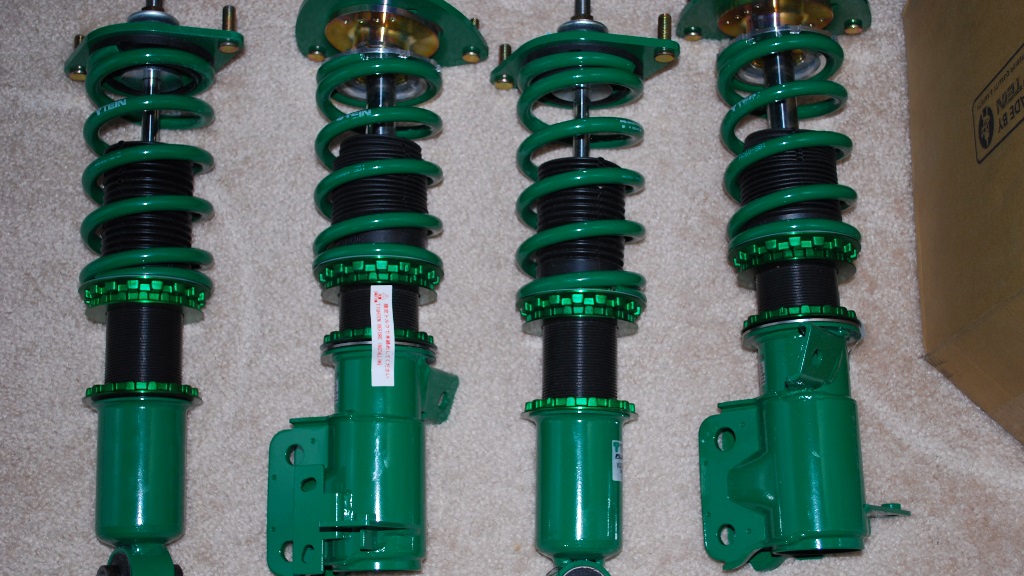

Papa_Smurf 12-11-2017 04:10 PM
New Tein Flex Z coilovers from FT86SpeedFactory. Plan on installing them as soon as my schedule allows.
