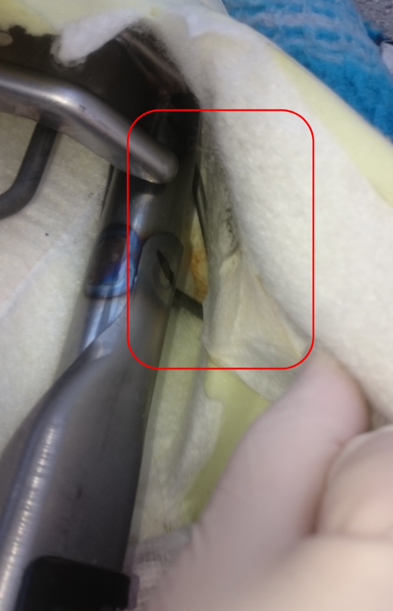

  6. Get smaller size, properly shaped lumbar support pillow
    Attachment 160317
    and inserted it between the frame and the foam
    Attachment 160318

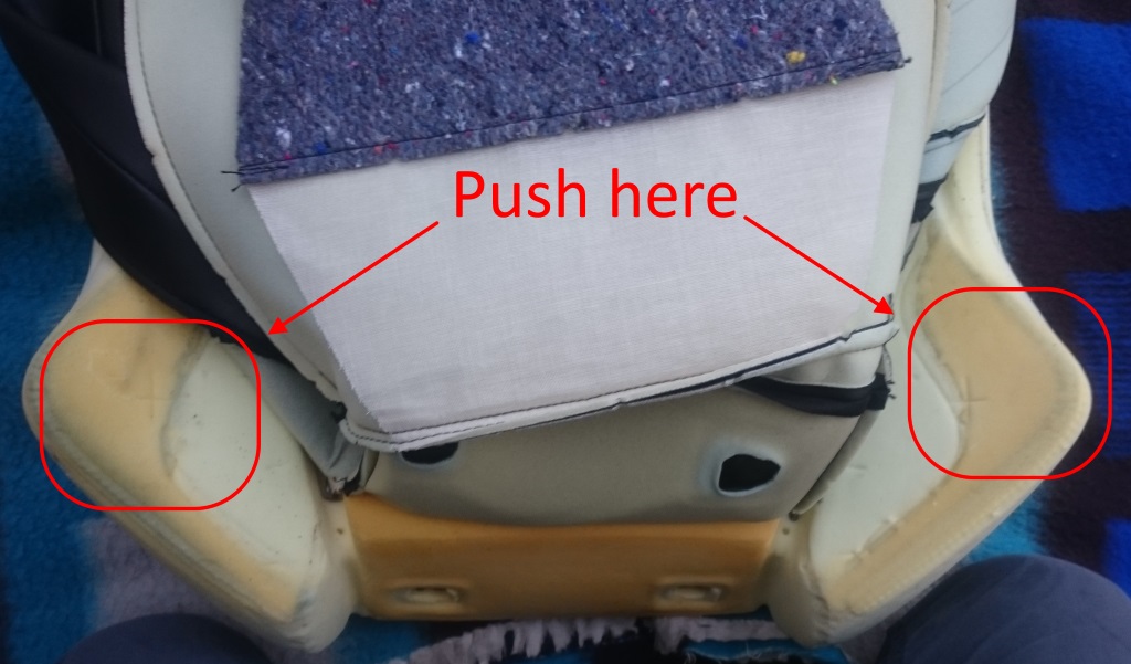

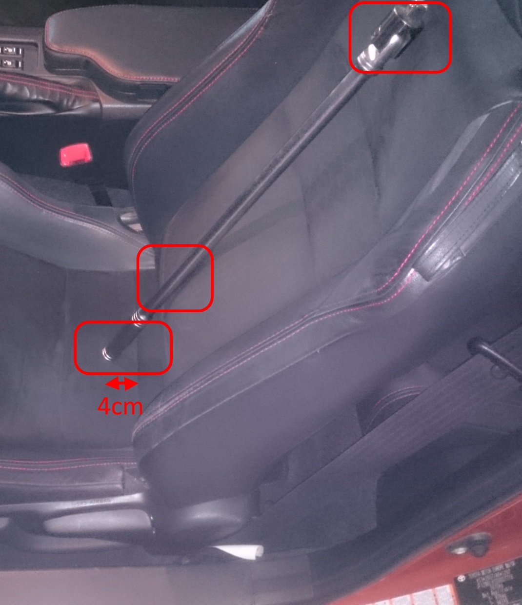

Second, I made more space to my shoulders:
  1. Removed the seat cover from the shoulder wings

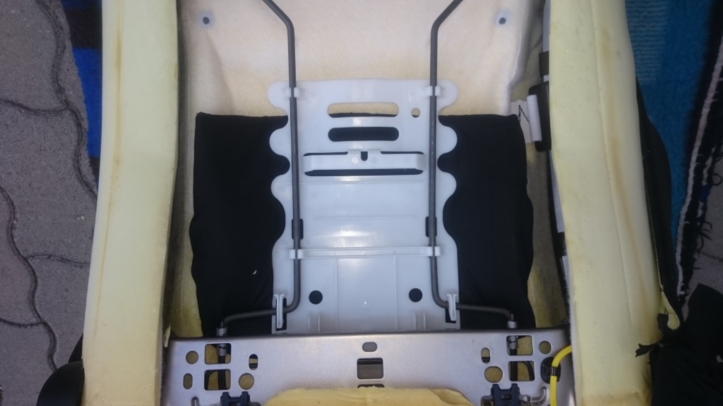

  2. Pushed the ends of the bracing inside the wings towards the ground to make more space:
    Attachment 160321
    The bracing inside the wings is just a curved steel bar welded to the main frame, you need a medium force here to not brake them:
    Attachment 160322
Surgery was then done. Reassembled the seat, felt free to use zip ties instead of the hogs (I used a micro flush cutter pliers for edge free cutting -> zip tie then could not hurt the fabric/foam).
Some minor adjustment was necessary after driving some kms, and it could be done without removing the seats.

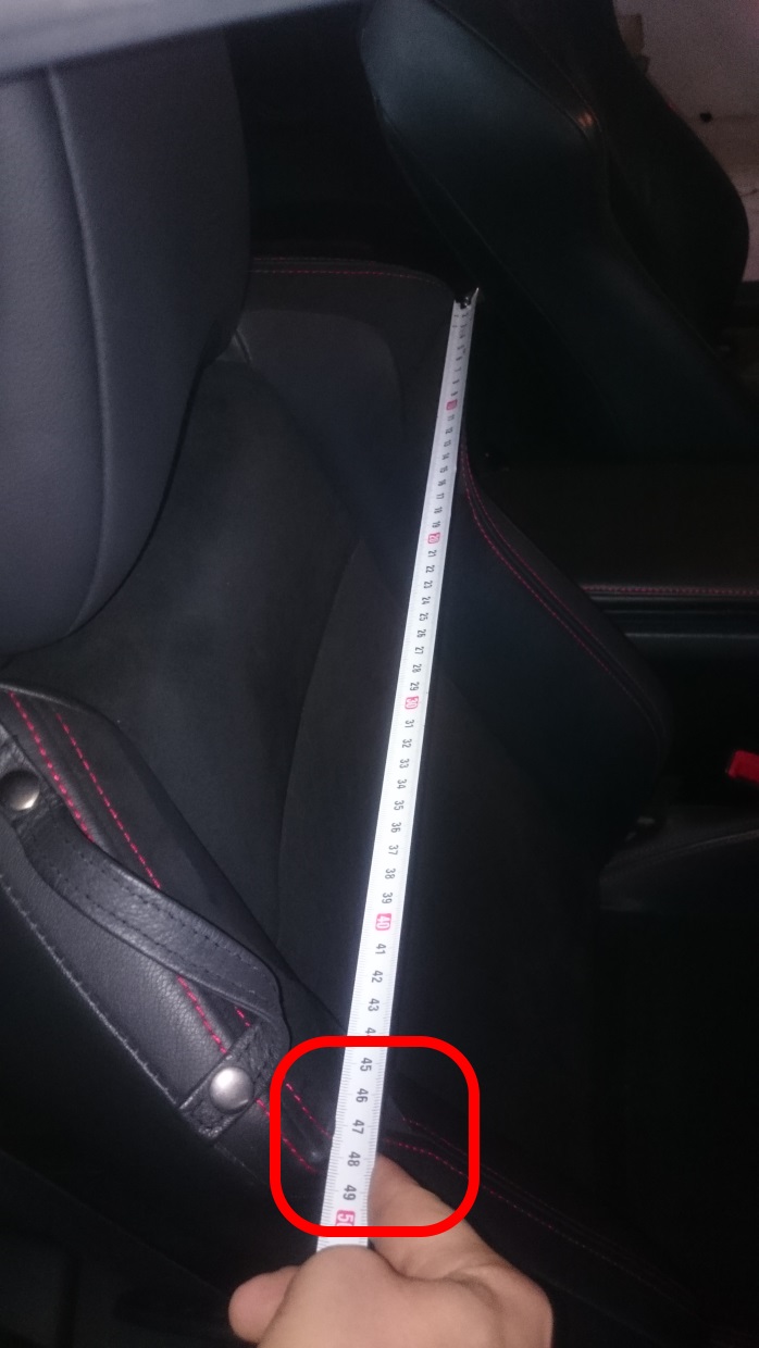

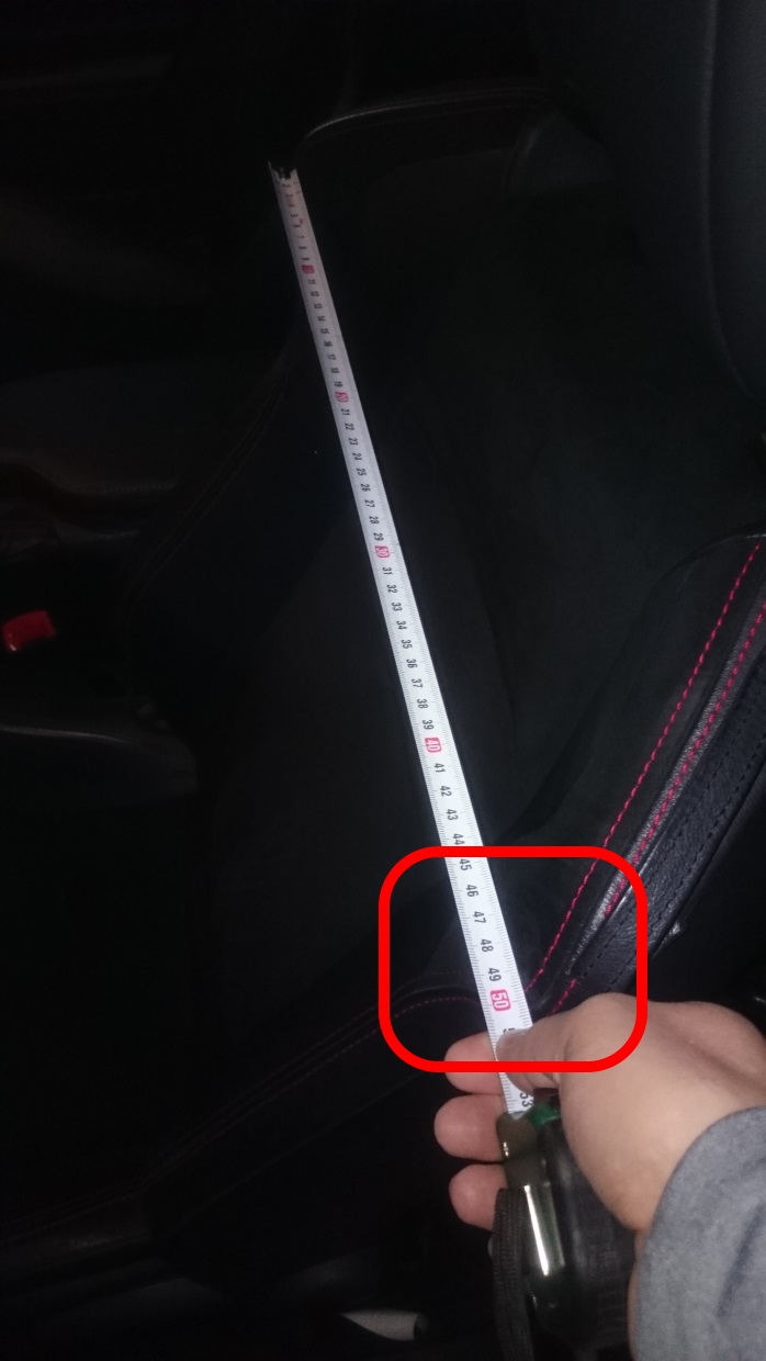

Finally there are some before/after pics. The shoulder wings are wider some 2.5 cm and I finally have very comfy lumber support.

Just did the shoulder mod, excellent result (Wide shoulders here). You can do this with out removing the seats at all. Just sit on the seat, put one arm through the headrest hole and use your elbow to push on the wing. Gained about 1.75 inch total space and seat feels amazing now.
