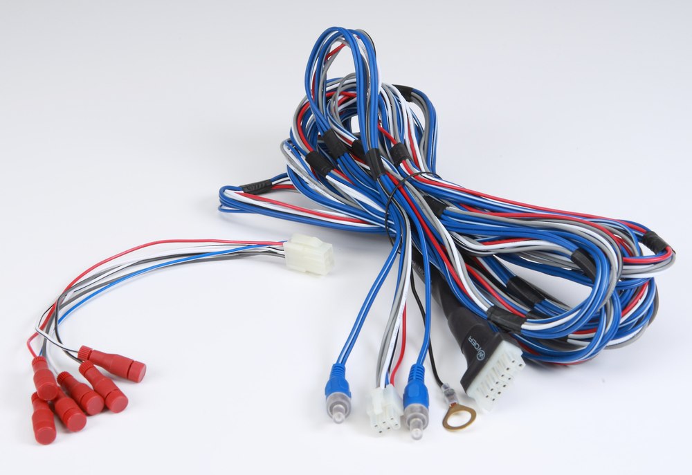

I recently purchased a Bazooka BTA8100FHC 8" powered subwoofer and followed this thread to install it. Installing it went fine, very easy and straightforward.
Once everything was hooked up though, I noticed the sound on the subwoofer seemed a little wonky...
https://youtu.be/TlQYzkASGD0
With the trunk closed, I can only hear that odd vibration when the heavy bass stops. I've not had this issue with any other system in any other car. IT functions normally and sound fine to me in the car with the trunk closed, but when I open the trunk and listen to the sub, like in the video above, all I can hear is that feedback-like sound.
Here's the caveat:
It's a refurbished unit that I bought for almost half off - the previous owner looks to have cut the positive and negative wires for the FAST harness. I spliced these together with some wire nuts. I then routed the wiring down the passenger side of the car along the door sill.
Before I return it, what might be another cause for the issue?

Mithosphere 10-18-2017 10:00 PM
Right, so I purchased another one - new this time - but after connecting all the wires, grounding it, and ensuring it had power.... nothing.... LED indicator won't light up, unit won't power on. Not going to be buying another Bazooka tube again.
So it too is being returned!
I get to dismantle the passenger side for the third time tomorrow and then tape over the holes left by the FAST harness.

After 1 1/2 years my Bazooka BT8100FCH stills sounds great. After a few Tail of the Dragon runs I added a couple of velcro strips between the floor mat and the trunk foam blocks for extra stability. http://www.homedepot.com/p/VELCRO-Br...0199/202261921
Sounds like your first sub was fubar.
I'm assuming you are using their FAST-9999 harness which comes in 2 parts. With a multimeter, and with the key on in the accessory position, check the positive pin side, red cable, of part 1 that connects to your HU for 12V to see if that's connected correctly, use one of the HU chassis screws/bolts as a ground for the multimeter.
If yes, then connect it to part 2, the long cable that plugs into the sub, and with a multimeter check that the corresponding ground and 12V pins on the connector (see pic) are getting 12V. If no, check your ground wire connection.
If yes, then when you connect part 2 to your sub, with the key on in the accessory position, the green LED should be on. Also make sure that the connector is fully seated on the sub.
