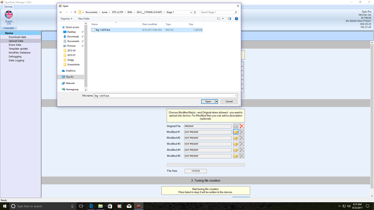

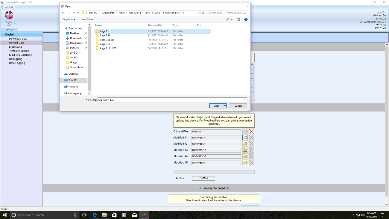

4 Attachment(s)
Originally Posted by steve99 (Post 2982374)
Ok its a real F40D rom not calid hacked
so you need to go to openflash site download site and download the tunes unzip and load up the ZA1JF40D tunes you want for your car to OFT
http://www.openflashtablet.com/downloads/
post here from shiv confirms F40D rom is supported
http://www.ft86club.com/forums/showt...36#post2618436
how to upload tunes
Uploading Files to Tablet - YouTube
Steve99 thanks for all the help but I cannot get a tune to load I am attaching screen shots of the process hopefully if I'm doing something wrong it will show up here.
Attachment 158583
Attachment 158584
Attachment 158585
Attachment 158586
I tried every tune file in the zip just in case and not 1 of them will load.
Xenov 09-23-2017 09:34 AM
Originally Posted by Freerider (Post 2982444)
So, how can they say "preloaded with tunes" and "no laptop required" when it's neither of those?... If I knew it was not as advertised, I'd have never bought it. Those are the two huge selling pts. (For me)
It was preloaded with tunes but for some reason my OFT wont load any of them and that's what I cannot figure out. I erased the preloaded tunes and downloaded the new tune Zip but same issue.
