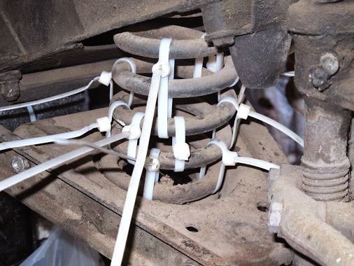

Remember: black cables ties for the oem look and white cable ties for the ricer look.
Attachment 157015
