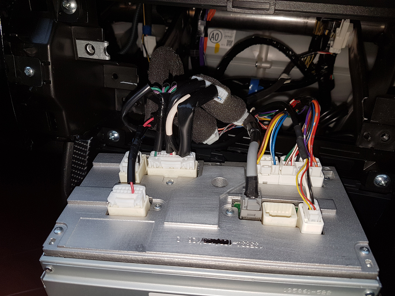

Here is my Factory head unit:
Attachment 155356
Attachment 155357

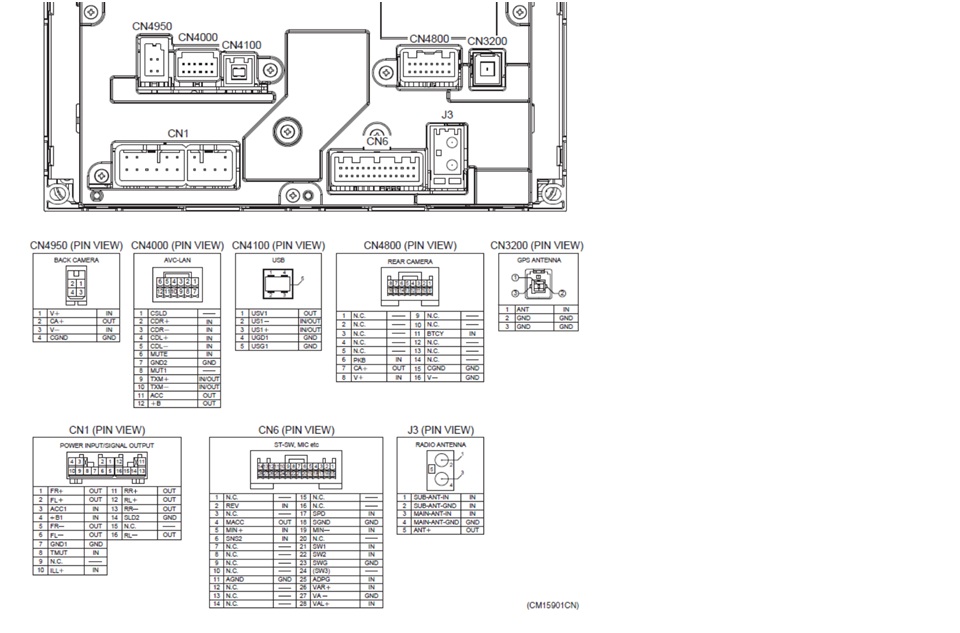

This is supposedly a pin-out diagram from a GTS model:
Attachment 155362

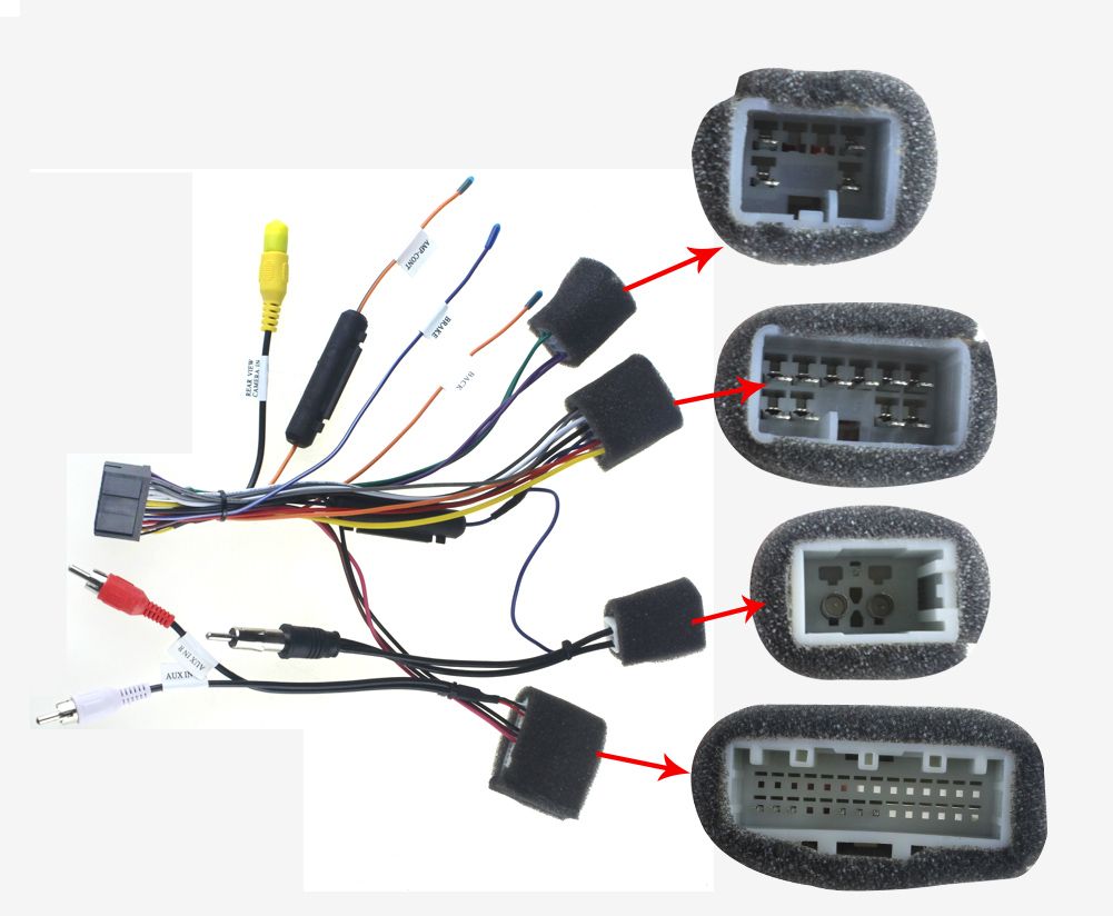

Here is the list of things I need from Joying:
Wiring Harness:

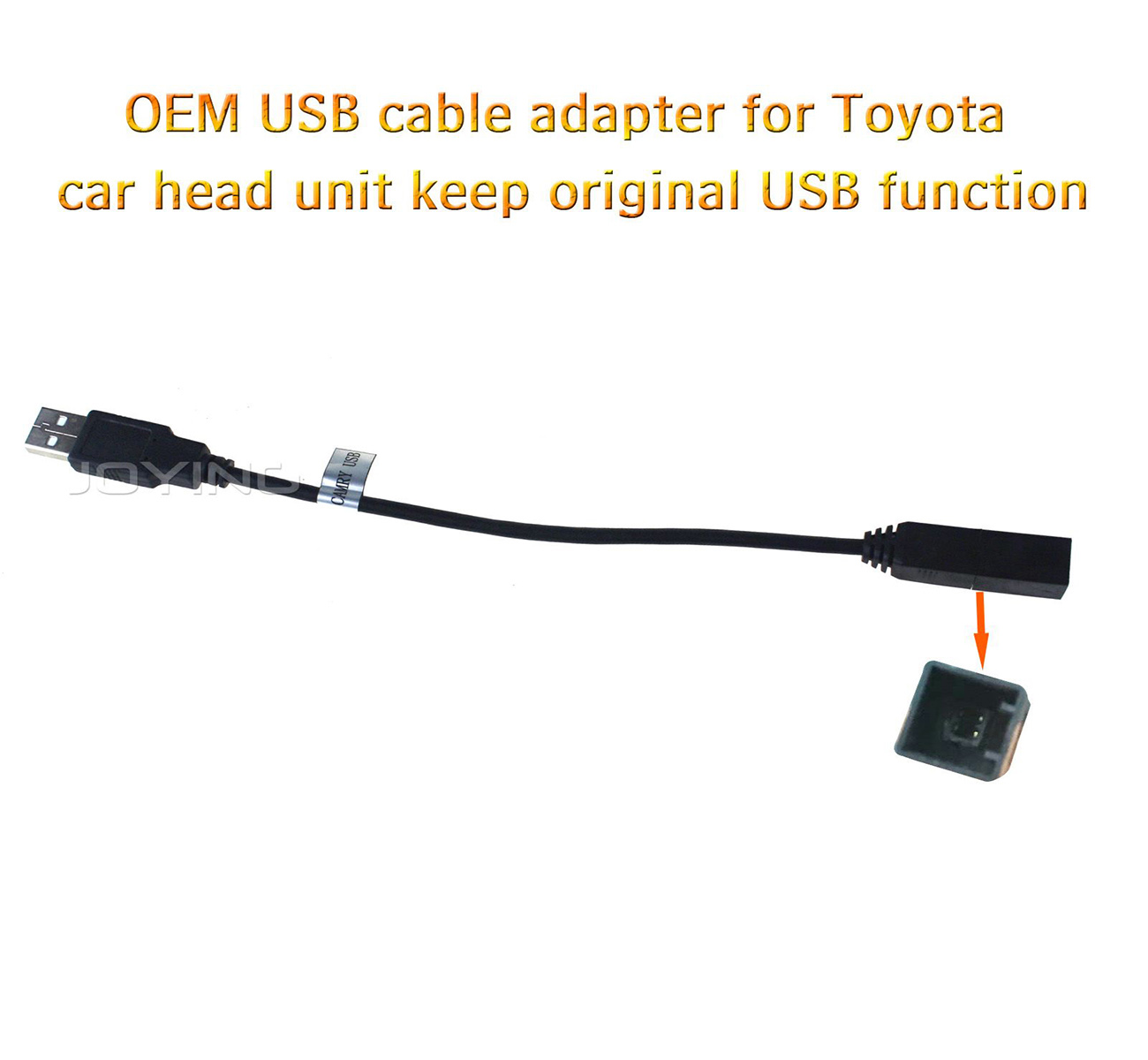

Attachment 155361
Aftermarket USB Adaptor:
Attachment 155359

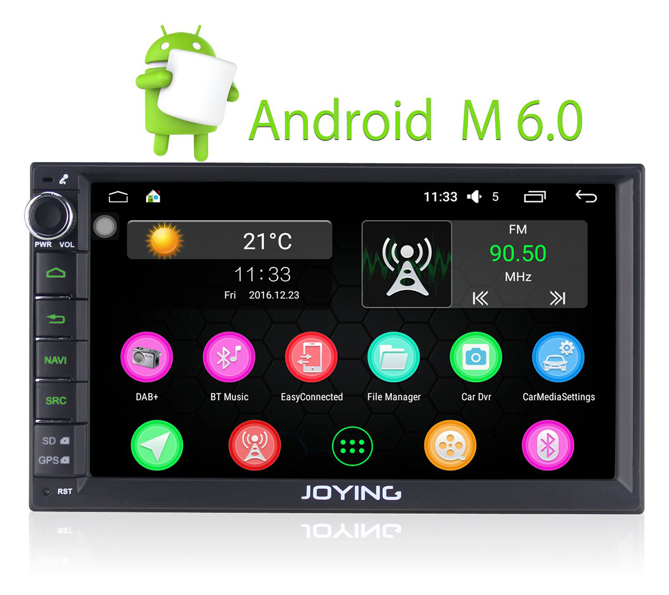

The Head Unit:
Attachment 155358

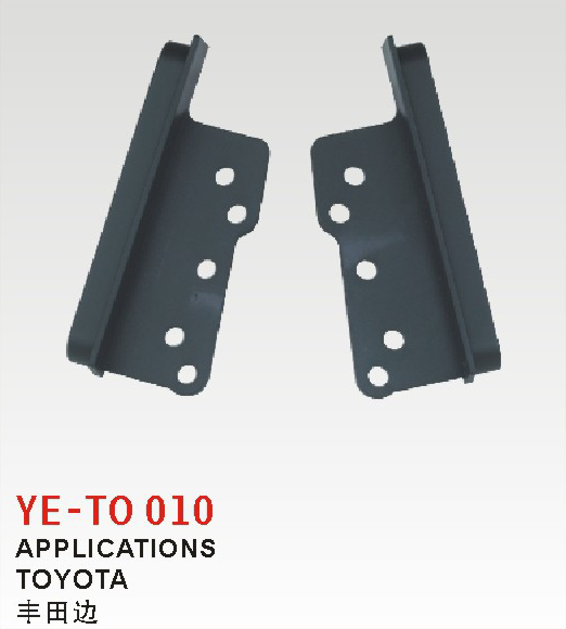

Trim Kit
Attachment 155360

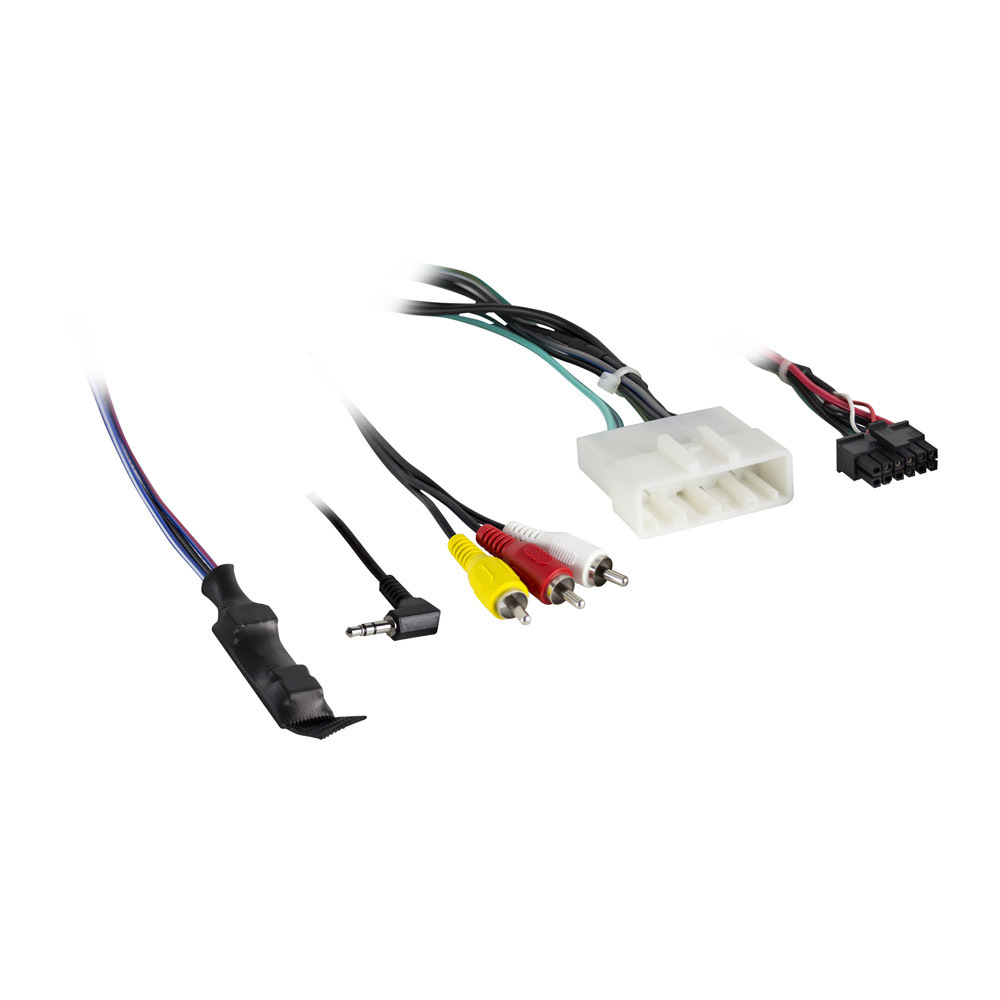

AX-SUB28SWC-6V (allowing the factory OEM camera to work)
Attachment 155565
Aparently this already has a 12 volt to 6 volt step down coverter, but I am yet to find that out when I wire it up.
