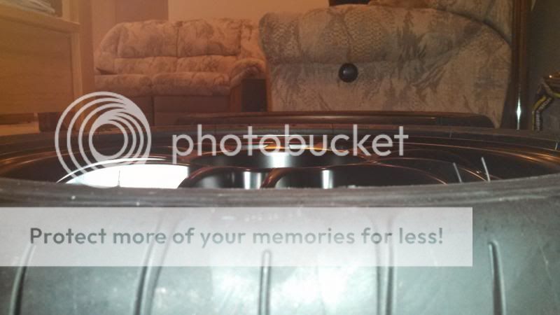

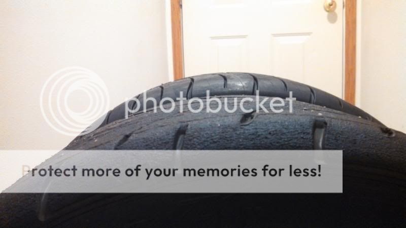

TRev 03-21-2013 01:40 AM
Width of Rival 225/45 17 (front) vs Z1 235/40 17 (rear) both on a 17x7 rim.
http://i674.photobucket.com/albums/v...ps6cf3508d.jpg
Diameter of Z1 235/40 17 (front) vs Rival 225/45 17. The Z1 is at five tenths depth and the Rivals are stickers.
http://i674.photobucket.com/albums/v...ps67a6d695.jpg
I will be running the Rival at all National events due to the contingency. If they had no chance it would be a different story. I tend to over drive a bit too so we should get along nicely.
