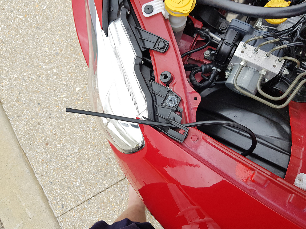

FRS2017 01-04-2018 06:27 PM
Does anyone have a clear diagram of how to remove the washer hose without too much hassle. I having a similar problem, the passengers side doesn't spray as good as the drivers side. I tried to put white vinegar in to unclog it, not tried to put a pin in the nozzle yet.
The dealer first said if its not the pump they will change me, but second said if its just a small clog issue then they wont.
I am having a feeling they going to bring me in say they wont charge me and then surprise me to say that they will charge me.

They are pretty buried in stuff so could be tricky. Don't use a pin it would be too big. Strip the paper/plastic off of a twist tie and use the wire from that. If clogged it is probably right at the nozzle so that should clear it. Of course whatever is clogging it can just get pushed back but at least you will know that is the issue.

Sapphireho 01-04-2018 09:11 PM
First thing I always do is disconnect it from the windshield squirter. If it flows it is the plastic cheap squirter. Go from there.

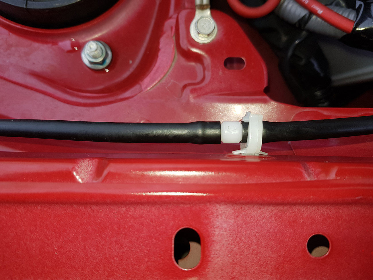

FRS2017 01-05-2018 02:50 AM
Drain the washer bottle from gunk
3 Attachment(s)
Ok update
I spotted a junction that joins the tube together under the hood (passenger side). I separated the two tubes and gave it a real puff from the nozzle and even drained the washer tank by hanging the tube outside the car and let it drain all the way.
There seems to be be some restriction in the passenger side nozzle as when I blew it from the drivers side nozzle it was less harder to blow. Put it this way like blowing a golf ball through a hose pipe lol.
Maybe the nozzle on the passenger side is gone or maybe blocked, going to get a pin and see if I can get anywhere, other than that I have to hope I get it fixed under warranty.
(update) - tried a pin and it went in the nozzle but of cause its L shaped, so will need something the same size and flexible.
Though I learned today how to drain the bottle that holds all the water for the windscreen :thumbsup:
Attachment 161570
Attachment 161571
Attachment 161572
Tcoat 01-05-2018 06:45 AM
Originally Posted by FRS2017 (Post 3024106)
Ok update
Try as I suggested before.
