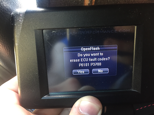

Once back they drained the oil and filled it again, then scanned the codes and said it came back the o2 sensor. Once I got home I plugged in my OFT and checked the codes myself and got these codes:
Attachment 153197
P0101: MASS AIR FLOW CURCUIT RANGE/ PERFORMANCE PROBLEM
P3700: ?
And YES, I searched the codes and tried to find any related issues but didn't have a lot of luck. Just led me to this site with a list of codes:http://ft86tech.com/frs-brz-error-codes/
I still have the car, but noticed the shifts feel harder when the car downshifts. I'm not sure if I should try to replace the mass air flow sensor or just wait and let them replace the o2 sensor first and see where that gets me? Would there be anything I need to watch for before or after it's replaced?
Any input would be greatly appreciated!!
steve99 05-05-2017 11:57 PM
Ensure maf sensor on intake tube is plugged in correctly, check for vacum leaks or hoses not connected. The other code seems to be a weird emissions code which may have triggered.
If all looks ok reset codes, drive sedatly and se if they return, they may have been stored codes
It does not look like an 02sensor issue
Hoever look at your ltft see if its high like above 10% anytime.
Also check comanded afr vs afr during wot runs and see if they are close
High fuel trims are usually and indication of fueling issues

Thanks for the response!
I ran a few logs with it and tried to get them in datazap but for some reason it wouldn't generate the actual charts for me. But the ltft's ran up to 10 or 11 a few times but was kind of all over the place between 1-10 and sometimes negative. I didn't have it logging commanded afr though.
I've never adjusted any of these myself as I had a tune from shiv, should I try the stock tune or a ots tune instead of the custom tune from shiv and see what changes?
I'll keep trying to get the datalogs to show up and add it if i can.
