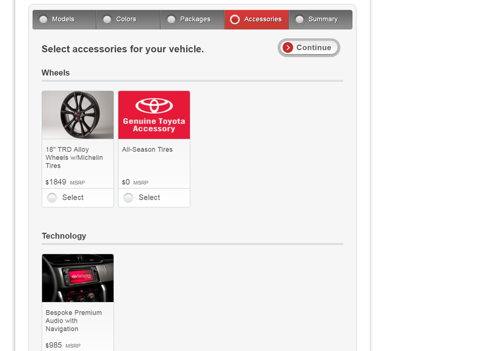

I noticed that the rules mentioned 17" wheels and thought it was a typo because 17" TRD wheels, offered as a port-installed option, appear to be a unicorn. (I can't find them on the Toyota website. Maybe I'm missing something. Do you have a link to the 17" wheels?)
This is from http://www.toyota.com/86/
http://i270.photobucket.com/albums/j...ps1hgaoifu.png
JermMX5 04-18-2017 10:39 AM
It wouldn't let me do a link that actually worked but this is what I found on their full site, are you on a mobile version?
Attachment 152349
Twinz 04-18-2017 10:56 AM
Desktop, but it wouldn't let me "build" without first entering a zip code and that was the issue.
I just googled zip codes for NH, plugged in one (03033) and then I could see a much larger list of options. They must only show stuff that's already on lots within a certain radius of the zip you enter.
Toyota could miss out on some buyers with their website set up like that.
We are considering trading in my wife's AT FRS and getting an 86. CS-legal 7.5" wheels make it more attractive and I couldn't even see them using a SW FL zip code.
