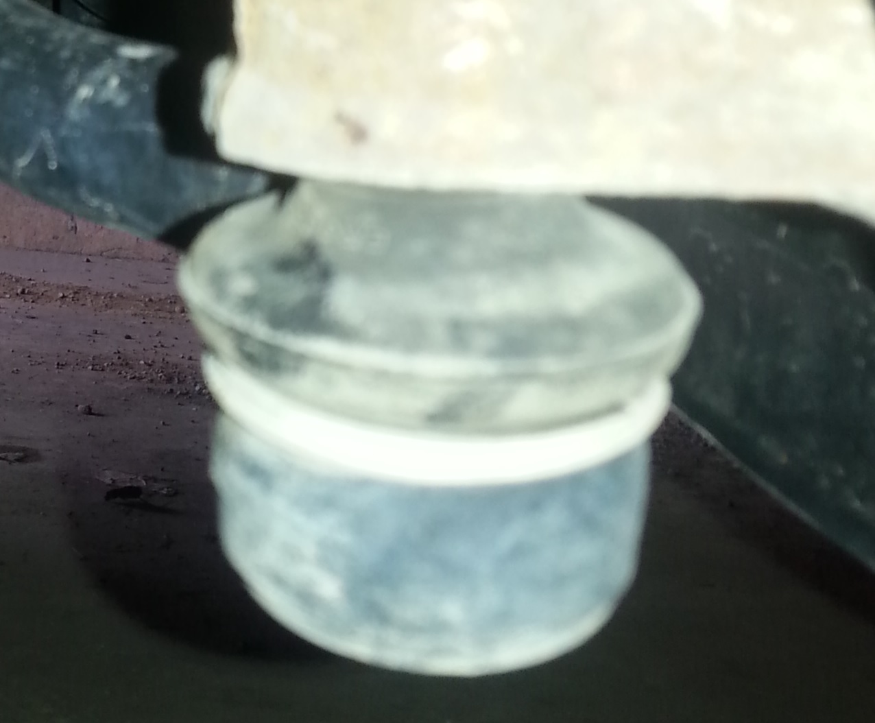

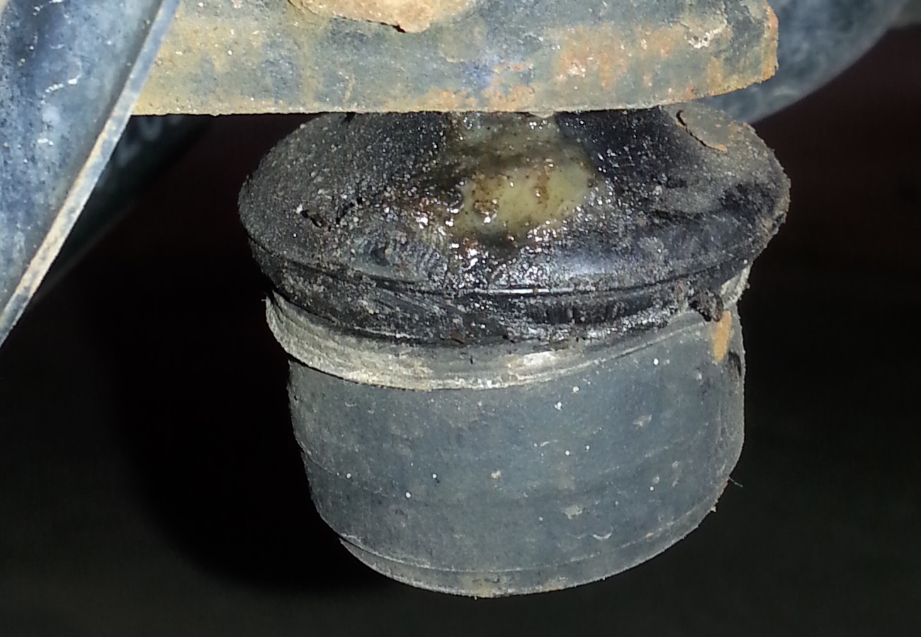

Kiwman 04-15-2017 09:32 PM
2 Attachment(s)
Alright! Finally able to update a little. So after jacking the front up and removing the tires I noticed this.
(This one is front left)
Attachment 152265
This is in comparison with the other side(ultra lens flare, I did not notice before I put the wheels back on)
(This one is front right)
Attachment 152264
Everything else on each side looked relatively similar, the ball joints look drastically different. I'm a bit nervous to take it on the road after this little inspection.

Kiwman 04-16-2017 12:22 AM
2 Attachment(s)
My apologies.
Front left
Attachment 152269
Front right
Attachment 152270
Close ups of the ball joint, nothing else seemed out of place.
humfrz 04-16-2017 01:00 AM
If you can't feel any excessive play in the ball joint, I'd suggest you look elsewhere.
Are you sure the sound is coming from the front ......and not the back .. ??
I have to enter my driveway at an angle also ...... and I don't hear any clank, so, I reckon that sound isn't "normal".
However, if I don't hit the driveway at exactly a 45 degree angle, I do get a sickening "crunch" sound ...... as the exhaust mid pipe scrapes .....:mad0259:
I'd suggest you have someone stand outside the car, while you enter the driveway, while your car is making that clank sound, and see if they can help isolate where the sound is coming from.
humfrz
MurderousPandas 04-16-2017 10:15 AM
Originally Posted by Kiwman (Post 2892502)
My apologies.
Front left
Attachment 152269
Front right
Attachment 152270
Not saying this is the problem, but your right side is missing the cotter pin on the castle nut, it must have been taken apart before. Could it be that this car may have had a problem previous of your purchase and it may have came back? Maybe it wasn't repaired completely/properly?
