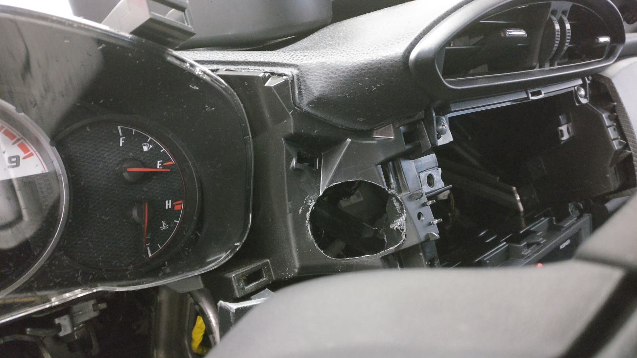

Then disassemble the interior trims around the tachometer, cut a big enough hole in the plastic behind it to be able to slide the long unit at an angle (since making the tabs line up will require you to insert it at an angle) and then cut a perfectly sized hole in the actual plastic trim.
