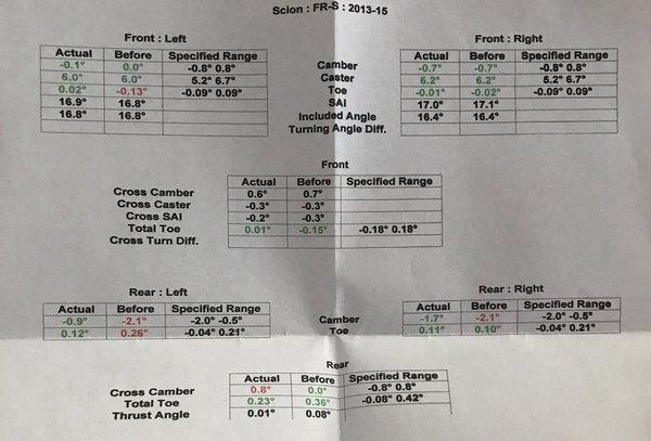

Hello. I jsut got a new alignment on my 2013 Scion Fr-S. I have Brand new rear tires and soon to be new front tires. My tires are Michelin PILOT SPORT AS3+ B9CR02RX-0817 -- 225/40ZR18, and my rims are 18inch enkei rims. I was having problems before when it came to certain left hand turns at around 40 degree apprx 60mph. I was hoping this alignment would fix it but it did not. WHenever I would make a turn at those measurements my traction control comes on and almost causes me to wreck bc it locks up my car. So since I am out of ideas I was hoping someone could tell me if this is normal for this car to do that driving on an every road, and i am just expecting too much. Below is my alignment specs. Thanks guys lmk what u think of the alignment specs

Are you slipping when turning that fast? How about turning off traction control

It doesnt really feeling like I am slipping. Its like Once i get halfway through the turn the car just cuts that shit on and like i said it can cause me to wreck bc it locks up the breaks or the tires...I would turn it off my i am scared i would crash or something lol. Im just curious as to if the car should be able to handle that. Mine is lowered 1.5inches so that should help as well

What suspension are you on? This car is known to hit bump stops deep into a turn which could unsettle it. Springs lower than 1inch or have soft rates have this problem.
Do you turn traction control off at VIR?

Have you ever changed your diff fluid? Torsen may be misbehaving.

Well now, cmurp96, since you have put larger wheels with wider tires on the car and lowered it, you have pretty much messed with the stock dynamics.
The car with its OEM suspension and wheels should not be "scary" when the nannies help out ..... yep, kind of a "whoa - what was that" ..... but not scary, when driven on average roads.
Like eluded to above, I would recommend that you either engage the nannies and learn how to work with them ....... OR, turn them off and learn how to drive the car all by yourself........;)
By no means am I a professional I simply meant I am not a 16 year old who just learned how to drive. I can drive well on a closed track that is suited for it. I will try that but before I did I wanted to get opinions. I have been told it couldbe the bump stops but idk how that works as i am not a car mechanic
No I called Toyota to do it about a months ago and they would not do it bc they do not "recommend it" :(
