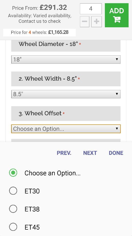

I'm looking get the 86 some new wheels. Would appreciate some advice. I've read thru the forums, believe I'll ok just want make sure. Would I have issue with rub/fitment on stock suspension what best size tire to run? https://uploads.tapatalk-cdn.com/201...5eb7fa5f0f.jpg
Attachment 148797
18 x 8.5
Et30
225/40/18
Thanks

Yes, 18x8.5 ET30 is fine.
edit: See below. I was thinking to myself 38 would probably fit better.

The front will stick out a lot without a lot of camber to bring the top in.
http://www.ft86club.com/forums/showthread.php?t=44291
Here's a +38.
http://www.ft86club.com/forums/showthread.php?t=12927
Rifle 01-27-2017 07:45 PM
If you want it to poke a little more, +30. But I'd say +38. Don't go +45. You'll rub inner fender if you plan to lower.

Thanks for pic links @gramicc101, front 30 is aggressive poke. Maybe 38 front rear 30 better fitment.
I don't know anything about camber truly. I like a little poke or that flush look. Just don't want to rub anywhere. I would like drop her down 1.5"max 2" one day.

If you're buying 4 of the same wheel, just get them all ET38 so that you can rotate the wheels/tires.
Or all ET30 if you really want it to poke out in front.
