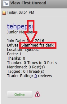

go_a_way1 11-25-2016 06:12 PM
Attachment 146451
My money is on it has something to do with this lol.
tehpepsi 11-25-2016 06:45 PM
Originally Posted by go_a_way1 (Post 2803599)
Attachment 146451
It can be, i was running on bc racing coilovers extrem low but i get the oem install 40 days ago(for the winter), and it start to have a resistance this week after not driving for a couple day.

Ultramaroon 11-25-2016 07:51 PM
Oh, shit. Good catch.
