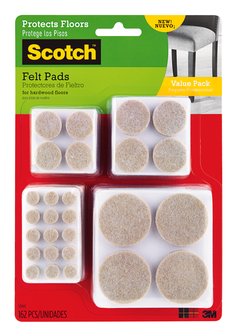

In other news I noticed the little rubber stop that the clutch pedal arm hits against in the footwell is chopped in half from wear lol, I guess I should replace that with something.

You know those adhesive backed felt pads? Perfect. I'm still on my first one after 2 years.
http://multimedia.3m.com/mws/media/1020384J
treminaor 11-25-2016 01:39 AM
Exactly what I had in mind, could have sworn I had some laying in a drawer but I'm still searching :iono:
Ultramaroon 11-25-2016 01:53 AM
It's the rare "actual" upgrade. That rubber thing is a POS.
treminaor 11-26-2016 04:51 PM
Ended up using some rubber drawer liner and 3M tape until I finally find those chair leg pads somewhere. Seems to work great so far but probably won't last as long as a chair pad.
