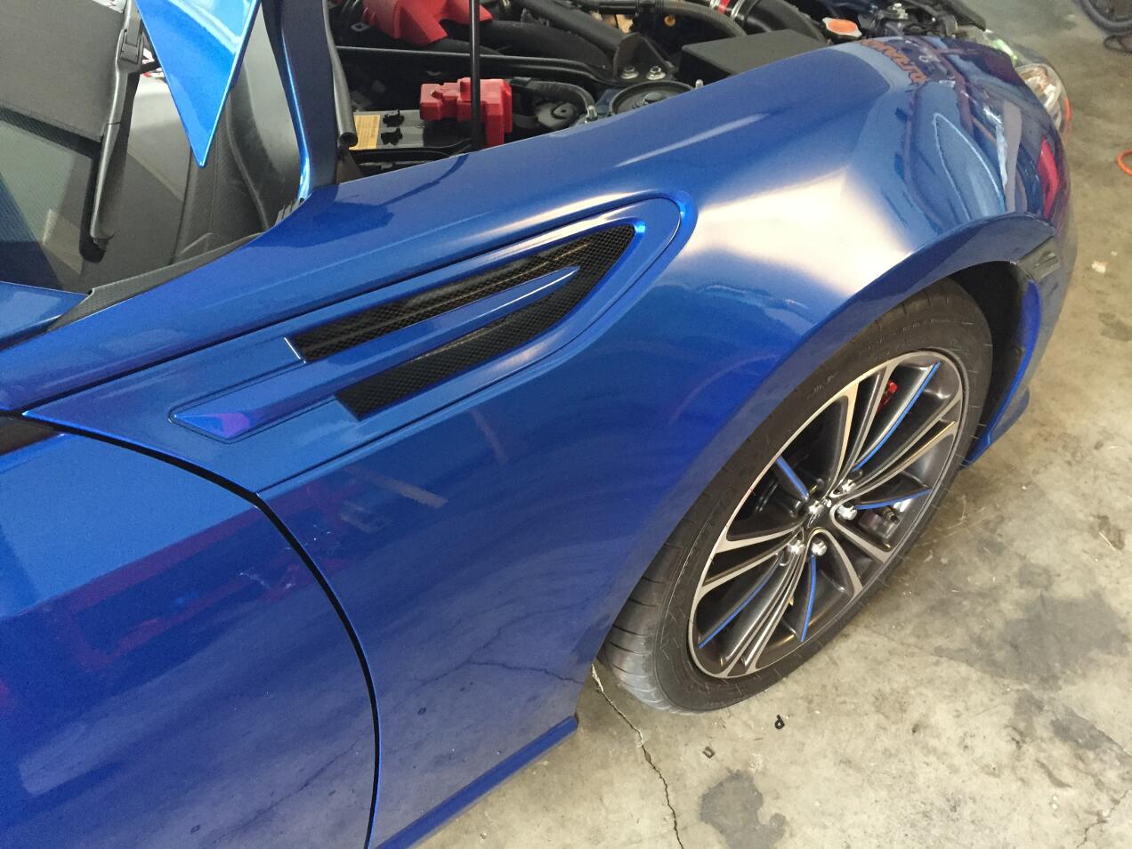

This the process and end result.

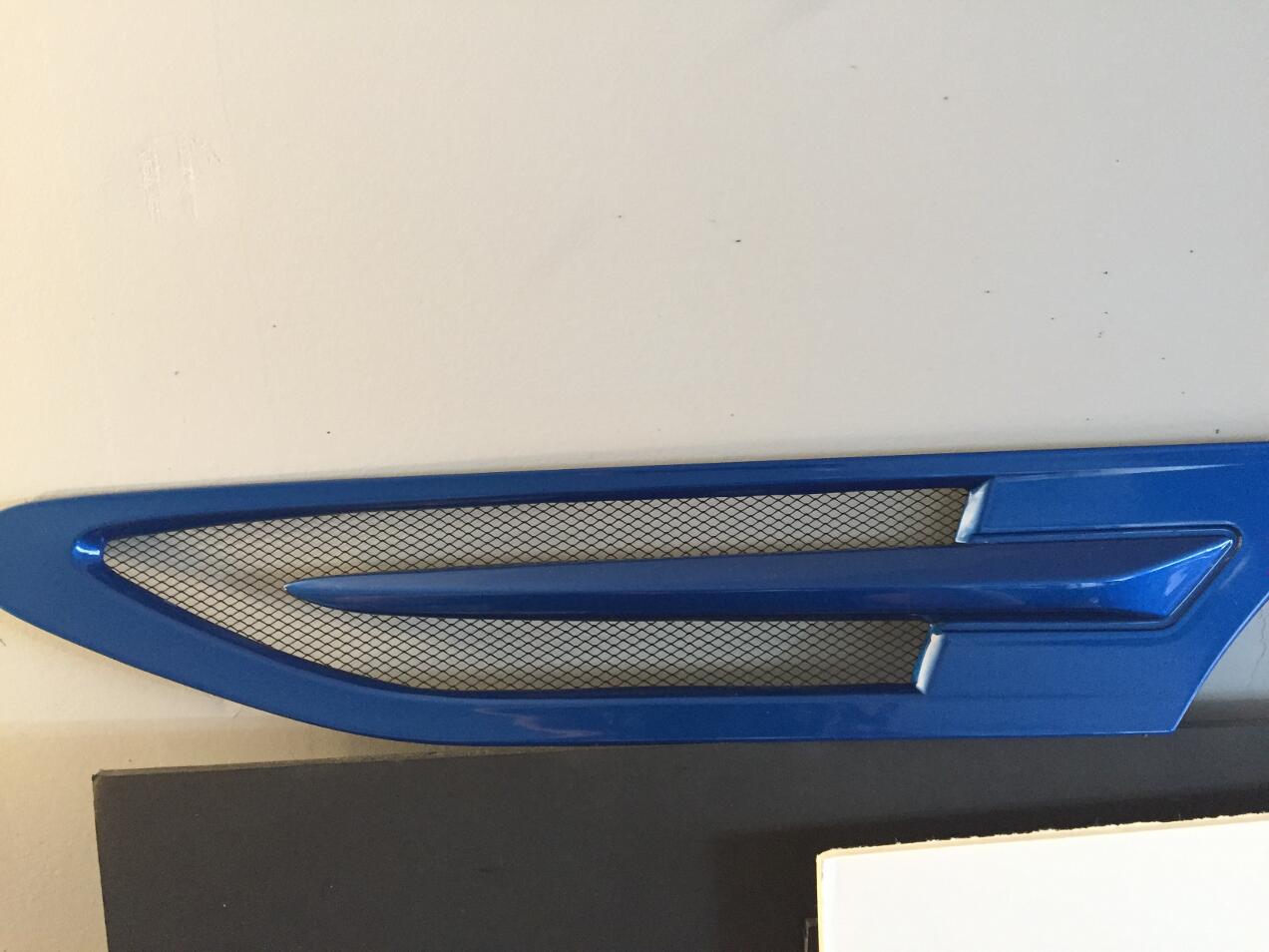

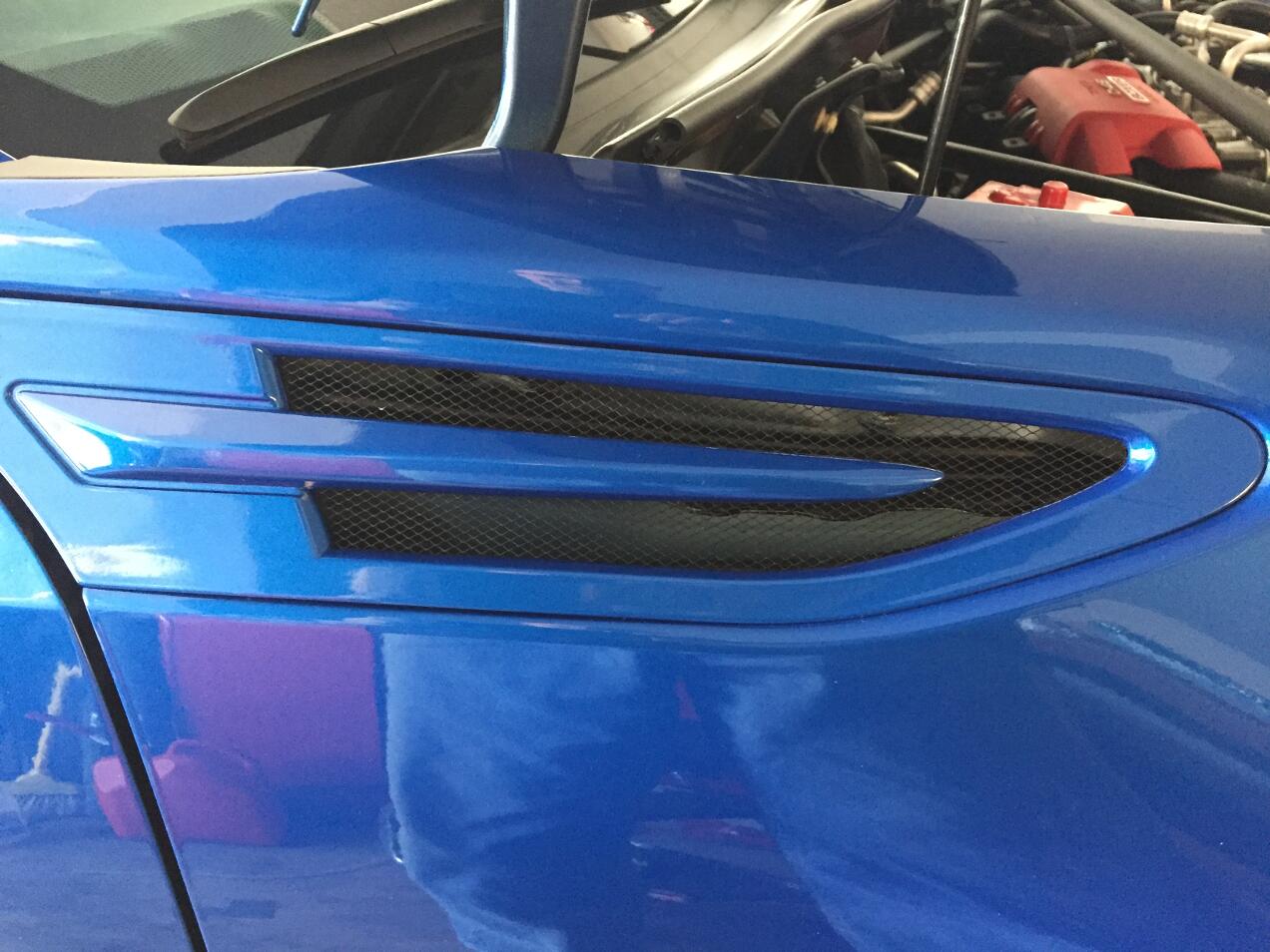

The functional vents started out as new oem vents which I cut out, painted and backed with black wire mesh.

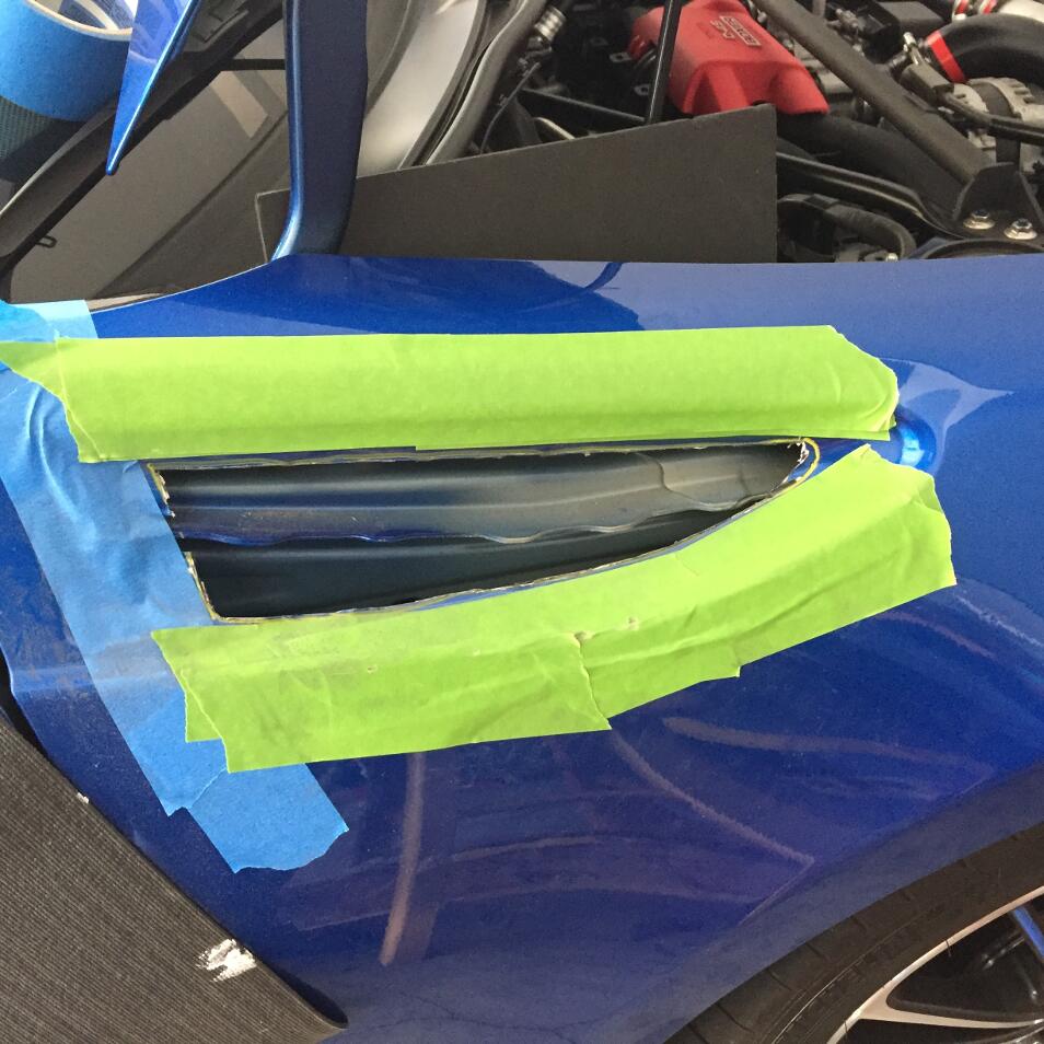

The fender cuts were done with a CBN wheel on a dremel (link here). This wheel works fine as long as you go slowly and guard against the dremel's chuck touching the bodywork.
I used two layers of tape holding a plastic ruler along the bottom of the vents. If you do this, try to keep intact the receptacle for the rear-most press clip; it helps align the new piece.

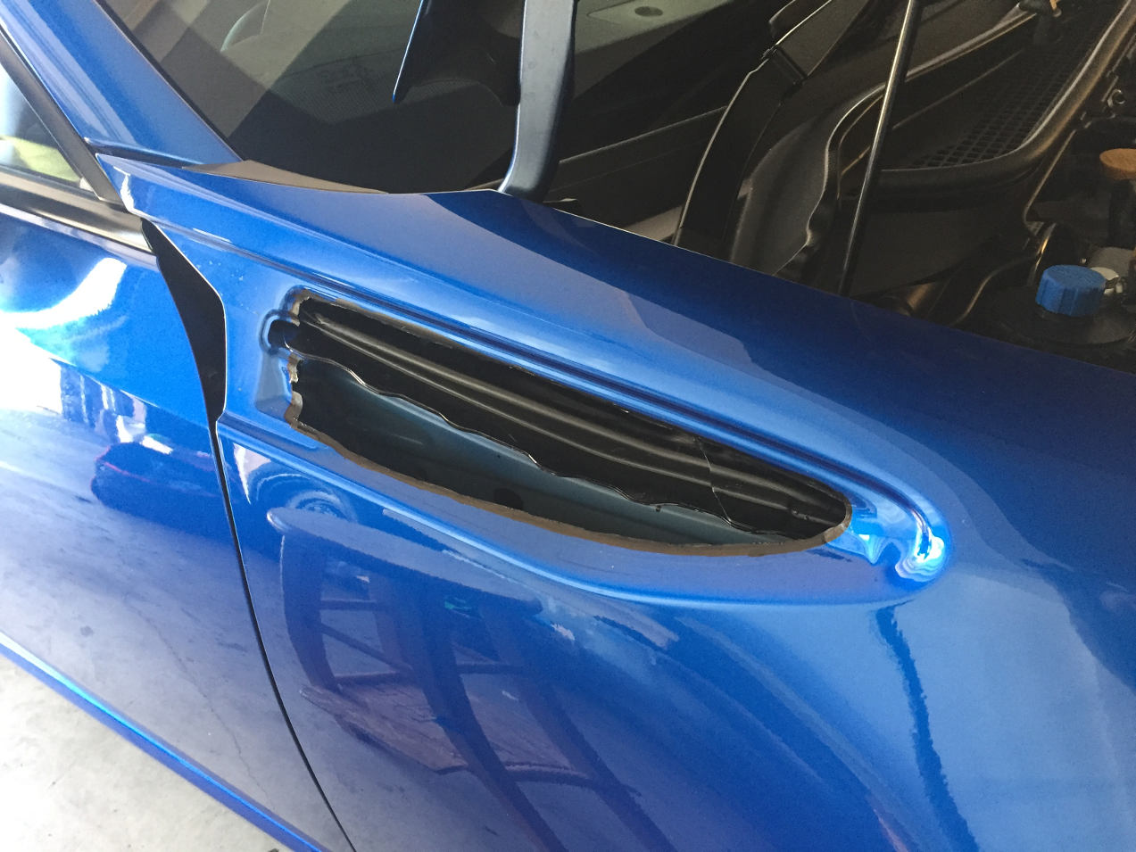

After cutting the fenders, I put two coats of flat black on the edges of the cuts to minimize potential rust. I also blacked out the inner body panel just behind the vent, which was still showing a lot of primer ( see 2nd photo.)

Mr Nerd 11-13-2016 09:07 PM
Very nice. Great job!
iamjacob 11-13-2016 09:30 PM
That has to be the cleanest set of functional vents that I have seen so far.
Awesome job Canyon!

I bought two extra OEM trim pieces to work on. The black trim bit pops off. The center opening was a time consuming task of drilling and dremellng to leave the center spar in place. I filled the back of the center spar ( it's normally hollow) with a cut down chunk of plastic and lots of body filler. It's now solid. The mesh screws to it as well as being stuck at the edges with 3M trim adhesive.
Rear surface painted black. Then several coats of priming, sanding and more primer on the outward facing surfaces. Then final paint and clear coat.
Lots of work but it turned out great. I spread out the prep over a few weekends.
