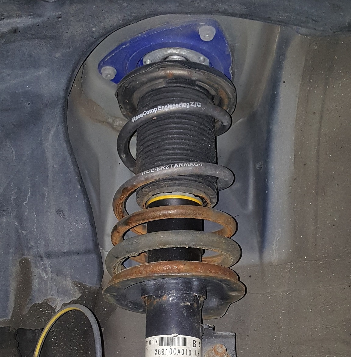

Are the rusted springs OK?
Hi,
I've used RCE Tarmac springs through two winter seasons.
Some days before, I found that those springs are rusted.
Attachment 143193
How can I cure these springs?
Will the rust remove work?
Thanks.
new2subaru 09-18-2016 07:53 AM
It's just surface rust and won't hurt anything.
Tcoat 09-18-2016 10:30 AM
That rust will become an issue if you leave it for 40 or 50 years but otherwise not a problem. If you want them to look nicer just clean them up with a scrubby or steel wool and brush on some rust paint.

HachiRo 09-18-2016 02:55 PM

Idk man, RCE and "lower quality" only work in a sentence when the word "aren't" is between those two.
Surface rust. Had it on my RSR Superdowns springs comes off quite easily.
Miniata 09-18-2016 05:11 PM
Like the others said, just surface rust. I've seen much worse. If it were my car, I'd clean off whatever rust I can reach without removing them from the car, and hit them with a good thick rust preventative spray oil 3-4 times a year.
makinen 09-18-2016 09:45 PM
Originally Posted by Norville Rogers (Post 2755634)
They are aftermarket. The springs (and the paint protecting them from rusting) are likely to be of a lower quality than OEM.
A "cure" might be to put the originals back on.
Will removing the rust (rust remove) be effective (work)? Who knows? What did you have in mind?
I missed "r" for the "rust remover" which changes rusts into stable compound.
I'd like to make rusting process as slow as possible without hurting springs.
Glok24 09-18-2016 10:20 PM
It seems like the general consensus is that its not a problem, but if you do want to remove it with a wire brush or some steel wool, and want to delay other rust from building up, you could get some cold galv spray https://www.amazon.com/Rust-Oleum-75.../dp/B00106H68W and galvanize the springs. not 100% sure how well it works on moving parts, but it should help
Teseo 09-18-2016 10:31 PM
I would considere a sandblast and paint, just for "looks"
wparsons 09-19-2016 09:58 AM

My stock springs were rusted when I took them out too... springs are steel, they'll rust.
Tcoat 09-19-2016 10:09 AM
DO NOT SANDBLAST SPRINGS!
Part of the manufacturing process of (most) springs is a shot peen after heat treat. This gives the springs strength yet flexibility. Sandblasting can mess with the metallurgy.
Teseo 09-19-2016 10:25 AM
My bad, then sandpaper? Light pressure
Tcoat 09-19-2016 10:36 AM
Oh you can hit it with anything you want by hand. They aren't glass. Just stay away from sandblasting.
Tcoat 09-19-2016 10:53 AM
Originally Posted by Norville Rogers (Post 2756051)
Might have meant beadblasting. Sometimes people use the term sandblasting for anything from shotblasting through.
True. Best to stay way from any type of blasting on heat treated and peened materials though. Not that beads would have any huge effect but why mess with it. Slap some anti rust paint on them and call it a day.
