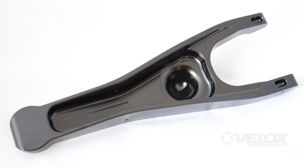

ichitaka05 08-09-2016 05:29 PM
While upgrading the clutch & slave cylinder, make sure to upgrade the clutch for. Cuz OEM clutch fork CANNOT handle it
Like Velox clutch fork
