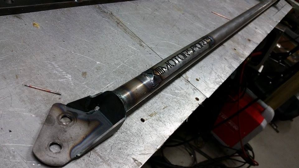

As of right now I believe there is two finishes available(custom colours available as an added option):
Semi gloss black (same as pictured above)
Raw finish + clear coat
http://i128.photobucket.com/albums/p...47381471_n.jpg
http://cdn2.bigcommerce.com/server50...0.1280.jpg?c=2
Now, it's very, very hard to deny that there is an extreme similarity here. With the former looking nearly identical, but having added about a half inch or so to the straight section for some reason. And it looks to be about half as thick. Adding length = longer lever arm = less rigid (is it easier to bend a tube that is 1 feet long, or two feet long?). Reducing thickness = less rigid. Reducing the thickness of the bar = less rigid. I did lots of testing and FEA in order to decrease weight of our strut bar (ours is 3.95lbs) and this one is 2.2, and I can tell you that the loss in rigidity in our design from reducing thickness was severe enough that we went with a heavier design.
So with that said, even though this bar looks nearly identical in shape (even down to the weld-on logo placement), it's not. So no need to call it a knock-off ;)
