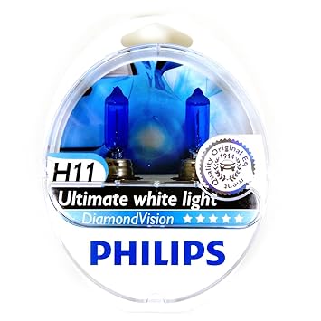

if you don't want to deal with LEDs/HIDs (retrofits) then go buy the Phillips Diamond Vision bulbs for both your DRLs and low beams
It will give you a luxury white bulb look with a slight hint of exotic blue
https://images-na.ssl-images-amazon....TL._SY355_.jpg
http://www.philipsxenon.com/images/philipsDV_33.jpg
