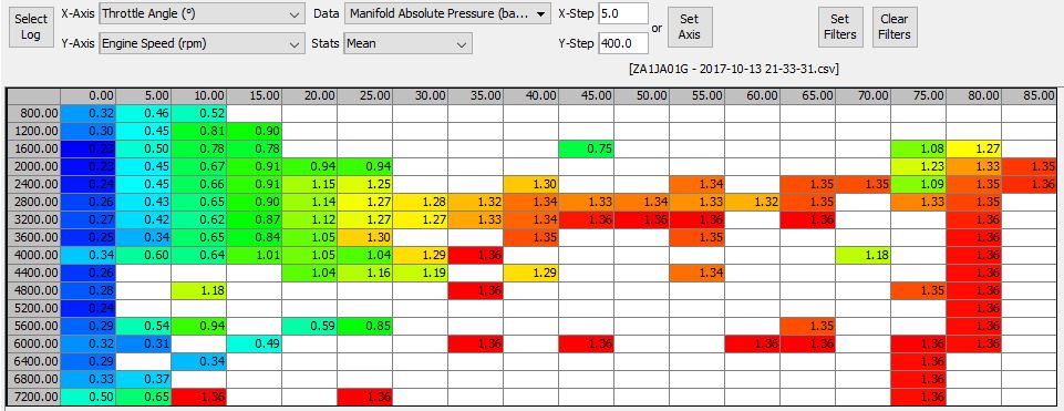

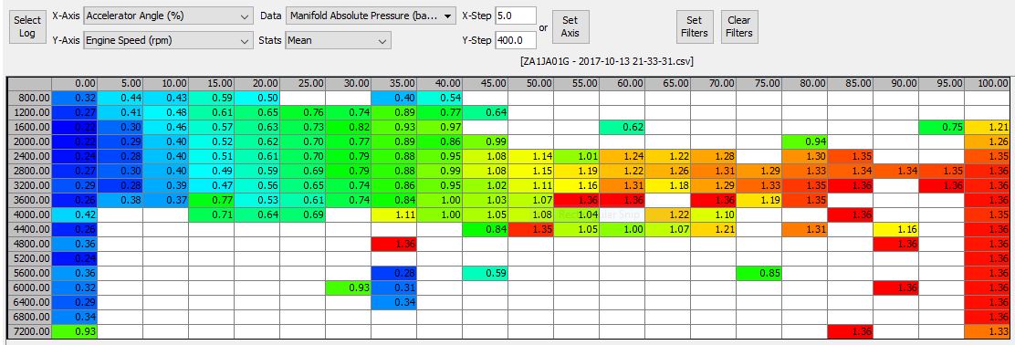

Kodename47 12-14-2017 04:58 PM
Originally Posted by Irace86.2.0 (Post 3016209)
At what throttle position does boost kick in or does not get bypassed?
A 3D log output of throttle vs RPM would easily show that.
On mine:
http://res.cloudinary.com/lagbv048w/...e_Pressure.jpg
http://res.cloudinary.com/lagbv048w/..._Pressure1.jpg
Irace86.2.0 12-14-2017 09:30 PM
Originally Posted by Kodename47 (Post 3016421)
Is it 1.36 bar or 19 psi including atmosphere or 5 psi of boost on the gauge, or is that 1.36 bar above atmosphere and thus 19 psi of boost on the gauge?

Kodename47 12-15-2017 08:45 PM
That's MAP, so 0.36 bar of boost. However mine is a Sprintex and running the OEM sensor, so capped reading. Where the output is 1 is where it's going into positive pressure.
Irace86.2.0 12-15-2017 10:18 PM
Originally Posted by Kodename47 (Post 3016892)
That's MAP, so 0.36 bar of boost. However mine is a Sprintex and running the OEM sensor, so called reading. Where the output is 1 is where it's going into positive pressure.
So it looks like at 40-50% of accelerator pedal is where boost starts.
Kodename47 12-16-2017 01:28 PM
Is on mine, however I have what I guess most would deem as soft pedal mapping so I would expect a more standard map to be around 10% less.
