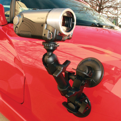

-   Tracking / Autocross / HPDE / Drifting (https://www.ft86club.com/forums/forumdisplay.php?f=39)
-   -   Best way to secure suction cup GoPro on driver side rear window? (https://www.ft86club.com/forums/showthread.php?t=107831)
hpde_addict 07-01-2016 01:27 PM
Best way to secure suction cup GoPro on driver side rear window?
I'm thinking of tethering it to the door handle.
Toyarzee 07-01-2016 01:32 PM
Are you asking how to use a suction cup, or how to install a backup incase the suction cup fails? Honestly if you're driving around with a swinging anchor banging against your door, I'd wager that it'll do more damage than it'll cost to buy another gopro if not just the housing should it be recovered... haven't had any issues with my gopro mount yet in both rain and very hot sunny days.
hpde_addict 07-01-2016 01:42 PM
Backup in case the suction cup fails. I'd rather have the unit banging against my car than have it fly into someone's windshield. For some organizations, it's required to be tethered anyway.
strat61caster 07-01-2016 02:03 PM
Originally Posted by hpde_addict (Post 2694552)
For some organizations, it's required to be tethered anyway.
Which orgs? None have bothered me so far.
Any decent suction cup to a clean window or bodywork won't come off unless something hits it.
Toyarzee 07-01-2016 02:10 PM
Originally Posted by hpde_addict (Post 2694552)
Backup in case the suction cup fails. I'd rather have the unit banging against my car than have it fly into someone's windshield. For some organizations, it's required to be tethered anyway.
We'll that's surely thoughtful of you, lol didn't even cross my mind.
Haven't seen an org mention anything like that myself either tho...
DocWalt 07-01-2016 02:52 PM
I've seen mention of this in some organization's rules but I've never been asked to do anything with mine just being suction cupped on... I've seen more of the sticky pads fall off than the suction cups. Heck, I can walk into my suction cup mount (by accident, derp) and whack it out of alignment before it pulls off of the window.
I'd probably just run a lanyard around your headrest post if you're concerned about it.
sirbobbinhood 07-01-2016 03:42 PM
Driver's headrest post is where I tethered mine. If you're in a pinch a bunch of zip ties will work.
CSG Mike 07-01-2016 04:11 PM
I'd rather lose the gopro, than have it bang against the car.
I 've lost more than a few gopros.
mav1178 07-01-2016 04:13 PM
For outside of rear window, I just use the 3M tape mount.
[ame="https://www.youtube.com/watch?v=A9stPHKiWTs"]Being passed like a BAWSSSS at Circuit of the Americas - YouTube[/ame]
This was using the regular GoPro 3M tape mount. I've had it on the window for close to 2 years now, and use it once every 6 months or so. Have never removed it and don't think it will ever come out unless I took a razor blade to it...
-alex
stevesnj 07-01-2016 04:20 PM
I have this Delkin Fat Gecko mount. It has lots of axis adjustments. It's more of a prosumer mount but it has 2 cups (in case one fails and for more mounting options) with lock and is made for mounting DSL cams so the GoPro will work perfect on it. It's good over 150mph too :P
http://www.delkindevices.com/product...ko-dual-mount/
http://www.bhphotovideo.com/bnh/cont...C&Q=&A=details
http://static.bhphoto.com/images/ima...000_610980.jpg
http://static.bhphoto.com/images/mul...IMG_438409.jpg
Toyarzee 07-01-2016 04:23 PM
Holy hell. I think you have to join the Pen15 club to use that mount lol.
All kidding aside there is really a ton of options out there... that sure looks industrious
stevesnj 07-01-2016 04:28 PM
Originally Posted by Toyarzee (Post 2694782)
Holy hell. I think you have to join the Pen15 club to use that mount lol.
All kidding aside there is really a ton of options out there... that sure looks industrious
I use my DSLR on it sometimes and I need the best bang for the buck..lol This is mostly aluminum and it's underpriced at $70 but If it saves my $800 camera it's worth it.
hpde_addict 07-01-2016 07:49 PM
Originally Posted by sirbobbinhood (Post 2694714)
Driver's headrest post is where I tethered mine. If you're in a pinch a bunch of zip ties will work.
If you crashed the front of the car, wouldn't that cause it to swing toward your face?
Toyarzee 07-01-2016 08:52 PM
You could always just keep the mount inside somewhere. That's become my preferred safety measure...
All times are GMT -4. The time now is 06:00 AM.
