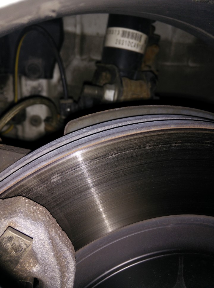

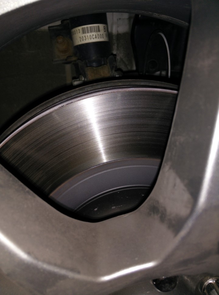

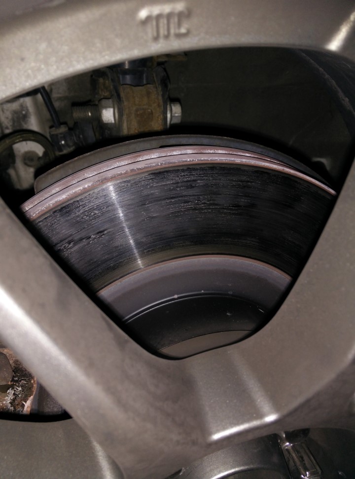

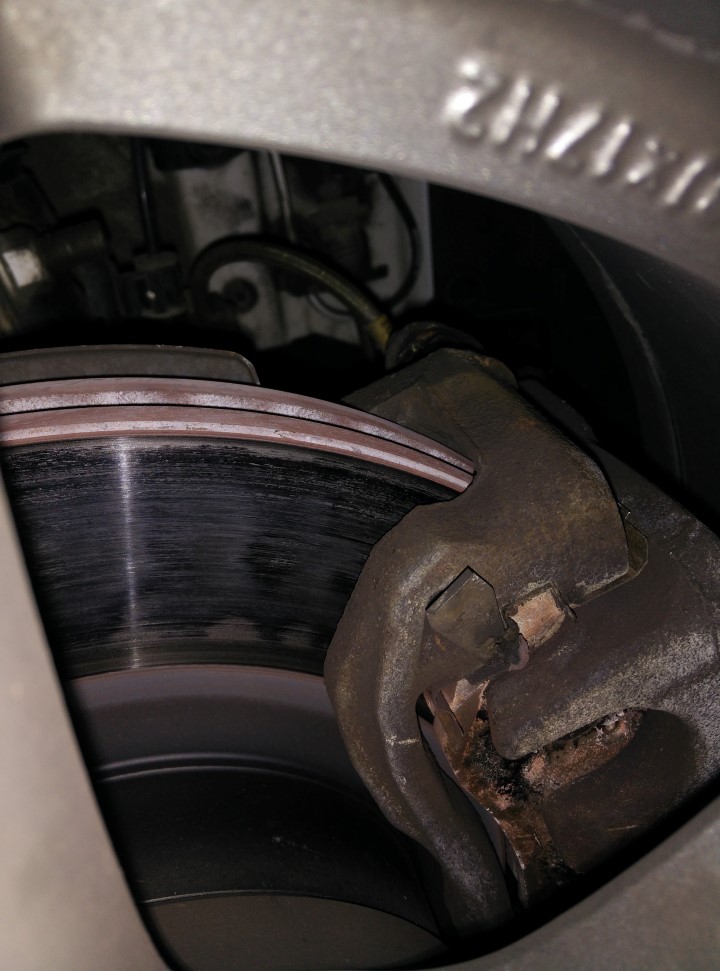

Do you have pics of your rotors? I can tell you if you're overheating the pad (which would also make the noise go away).

4 Attachment(s)
@CSG Mike
Passenger Front
Attachment 138814
Driver Front
Attachment 138815
Passenger Rear
Attachment 138816
Driver Rear
Attachment 138817

@drewbot you need to get a bit more heat into them, judging from the pictures. As @OkieSnuffBox said, get em hot enough that you can smell them, and then let them cool down while rolling, without touching the brake pedal.

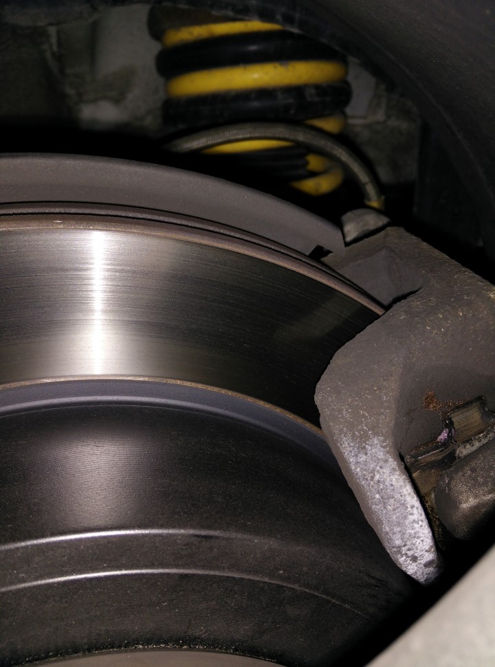

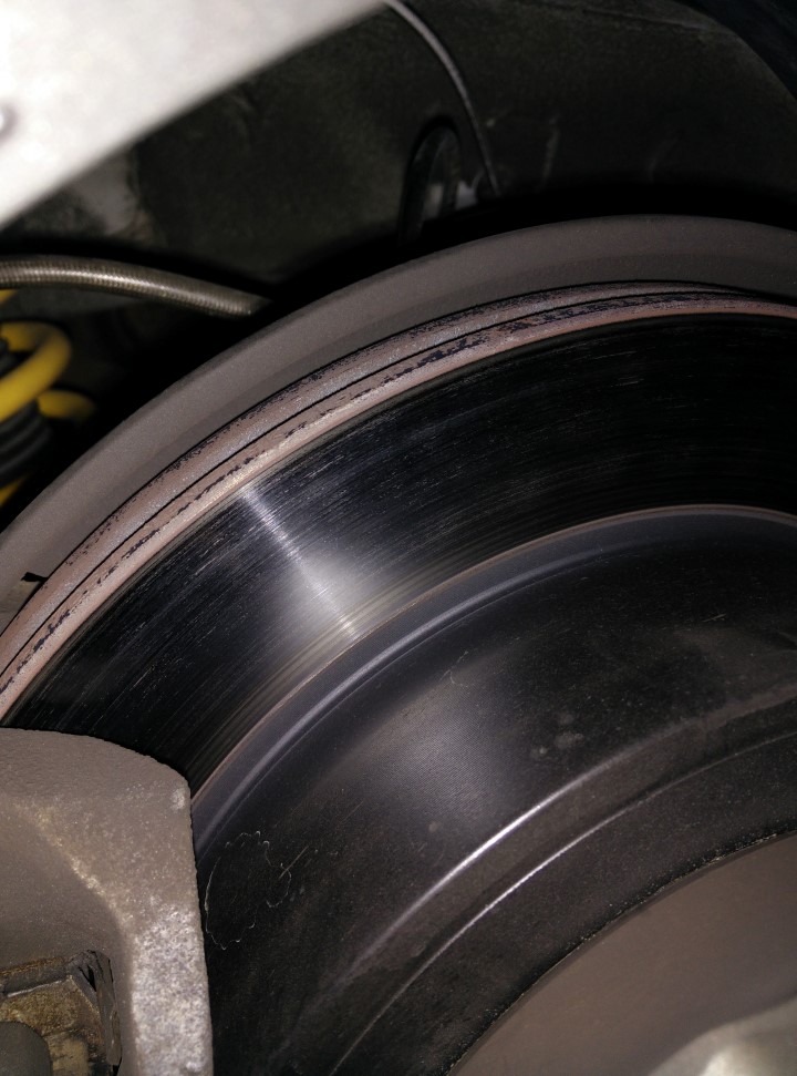

4 Attachment(s)
Update:
Following @OkieSnuffBox @CSG Mike @wparsons advice, I went and did another bed in. Rotors below
Attachment 138914
Attachment 138915
Attachment 138916
Attachment 138917
After driving about 50 km the next day, both issue #1 and issue #2 have been minimized, but are still present. I am completely OK with the sound levels (for now). I wonder how long this transfer layer will last...hopefully until the next track day

CSG Mike 06-19-2016 11:02 PM
Tapering the edges can help with noise.
@drewbot you certainly got them hot enough! Under street driving conditions, try braking slightly harder, and avoid "very light braking". That should help significantly.
