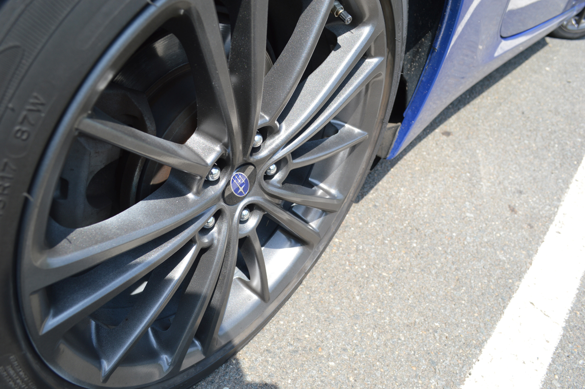

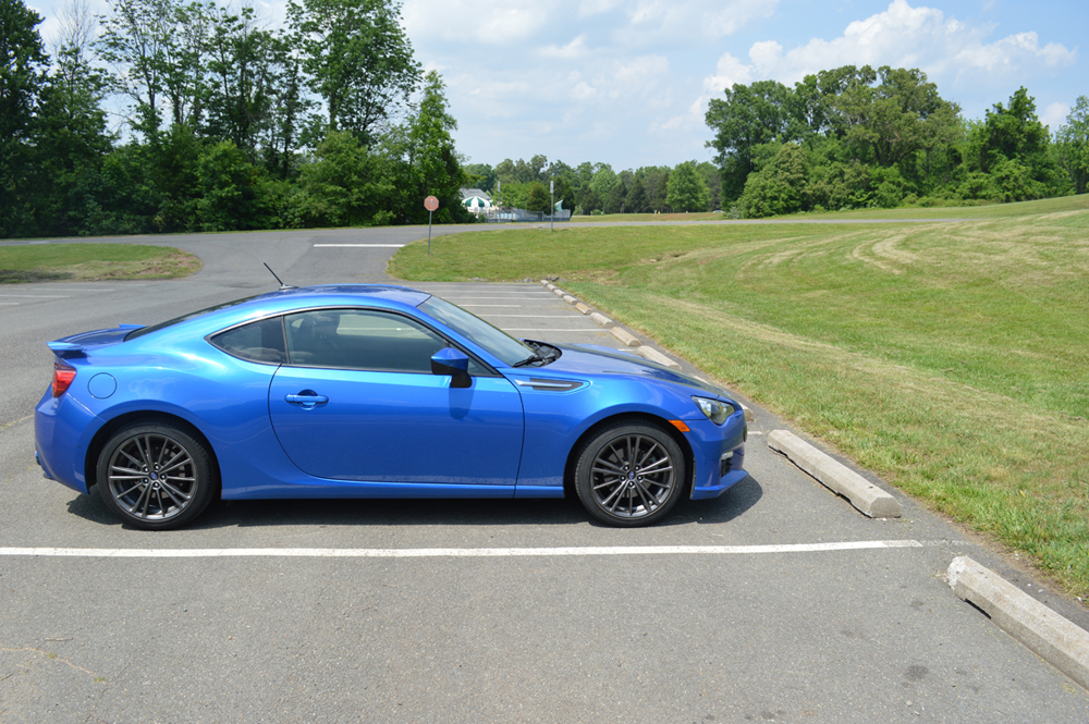

Couldn't stand the stock wheels and didn't have enough money for new ones so i decided to paint them. After a long sanding process (took 2 1/2 to 3 hours), I used Rustoleum primer, VHT Graphite wheel paint and Dupli-color clear coat. Pretty happy with the results!

That looks great! Would love to do the same to my wheels. What grit sand paper did you use and how many coats of paint?

Thank you!! I used a cup brush (attaches to a driver), followed by 320 grit and then 1000 grit to smooth it out. 3 coats of primer, 2-3 coats of color, and 2-3 of clearcoat.

Great job! Looks a million times better than how the wheels look stock.

You probably don't need to go any finer than 400 grit before primer, and 800 grit if you need to smooth out after primer.

I pained my IS300 rims with a very similar process. Took me a full weekend of basically working on it all day both days. Cleaning and sanding was the hardest part. I used Dupli-Color for the primer, base and clear on mine. Did 3 coats of each. My IS300 is black and I also went with graphite. It came out really nice and held up fine for the past year. The only problem I have with mine is at the lip of the rim. If you aren’t taking the tires off it’s hard to clean the lip and also hard to get a good coat on the lip. So my rims now have the original surface coming through just a tad. Not that noticeable unless you get close. But the main surfaces still look perfect. Nice gloss finish still.
To really do this job right I would say you need to do it with the tires off.
