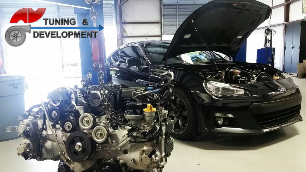

zenex 05-13-2016 06:21 PM
Build thread. Subaru BRZ #ProjectNightmare
It's always been my dream to build this car for insane amounts of power.. still in progress of build
Let's start with the parts list:
- Avias forged pistons and connecting rods 9:1 compression
- Forged crankshaft
- FBM stage 2 shortblock
- FBM stage 1 heads, ported and polished
- Ferrera valves
- Ferrera Springs
- Ferrera valves
- ARP head studs
- ID 850cc Port injectors
- ACT 10.5 lb lightweight flywheel
- ACT 6-puck sprung clutch disc
- ACT 70% increased clamping force pressure plate
- Full race turbo kit
- Borg warner 6758EFR turbo
- Full race 3" cat back exhaust
- Upgraded rims to 18x10.5 with sticky rubber
AEM gauges
Tuned via ECUtek http://uploads.tapatalk-cdn.com/2016...84b75b53cd.jpghttp://uploads.tapatalk-cdn.com/2016...aebd17c0f2.jpghttp://uploads.tapatalk-cdn.com/2016...276d35eda5.jpghttp://uploads.tapatalk-cdn.com/2016...8085d5e948.jpghttp://uploads.tapatalk-cdn.com/2016...58b5ae0e76.jpghttp://uploads.tapatalk-cdn.com/2016...6746294539.jpghttp://uploads.tapatalk-cdn.com/2016...27047f1c2d.jpghttp://uploads.tapatalk-cdn.com/2016...df7d83ba58.jpghttp://uploads.tapatalk-cdn.com/2016...efbbba66a7.jpghttp://uploads.tapatalk-cdn.com/2016...da483dc6ca.jpg

zenex 05-27-2016 02:12 PM
Attachment 137683
Sent from my SM-N920V using Tapatalk
-Phil 05-27-2016 02:22 PM
Any plans on changing out the injectors? Everything looks great.
zenex 05-27-2016 02:37 PM
Which ones?
-Phil 05-27-2016 03:48 PM
Originally Posted by zenex (Post 2664091)
Which ones?
the 850CC ones will run out at around 480-520 WHP. At least in our case even with plenty of base pressure it was not enough.
