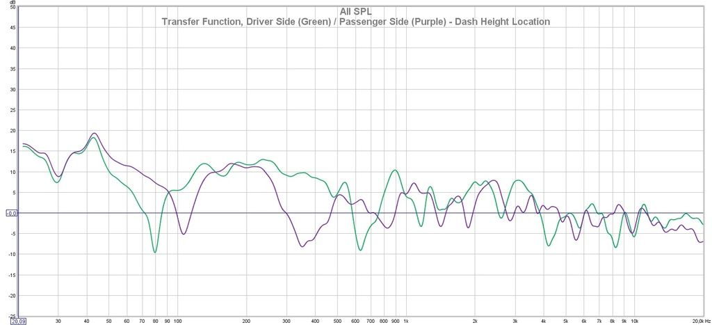

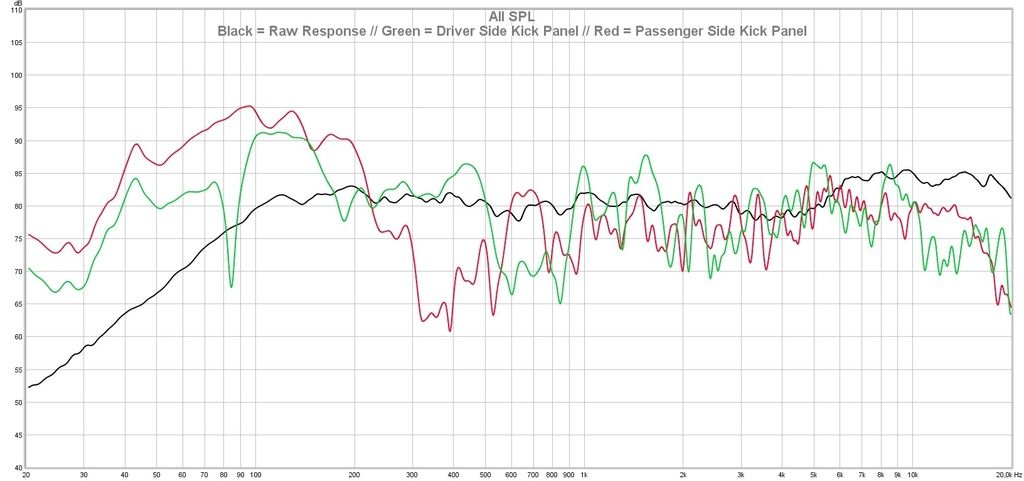

Well, take a look at these measurements...
I measured a bookshelf speaker outside, 3m from ground and 10m from any other boundary. Mic position; 0,5m directly on-axis in front of speaker, 4V input@1kHz. Placed a graph offset of -6dB on this response to represent a 1m distance equivalent volume, this is "Raw Response" in graphs below.
I then placed the same speaker, with the same input volume in the car. Microphone location; 4 inch in front of headrest.

Kick-panel location:
http://i1204.photobucket.com/albums/...psonvxkzm3.jpg
Dash-height location:
http://i1204.photobucket.com/albums/...psnbwkplaz.jpg

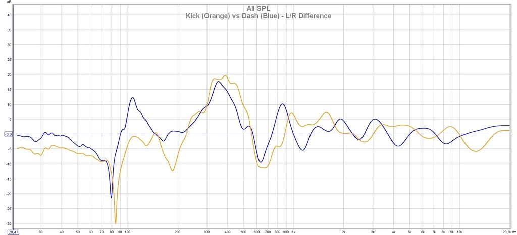

L/R Differences of Kick/Dash location
http://i1204.photobucket.com/albums/...psoevv3xmr.jpg
http://i1204.photobucket.com/albums/...psr5paytbn.jpg
http://i1204.photobucket.com/albums/...psxbvpb7el.jpg
Conclusion:
The measured car response got response deviations of 40dB (!!) compared to the raw response. That's how the car's transfer function affect the response in this car. It's different for each car, depending on cabin size, speaker location and listening position. Some of the issues (nulls) can't be processed away. However, in order to attain proper tonal balance and staging in a car you absolutely need equalization. NOT "as little as possible", rather "adequate" amounts, to correct the deviations introduced.
